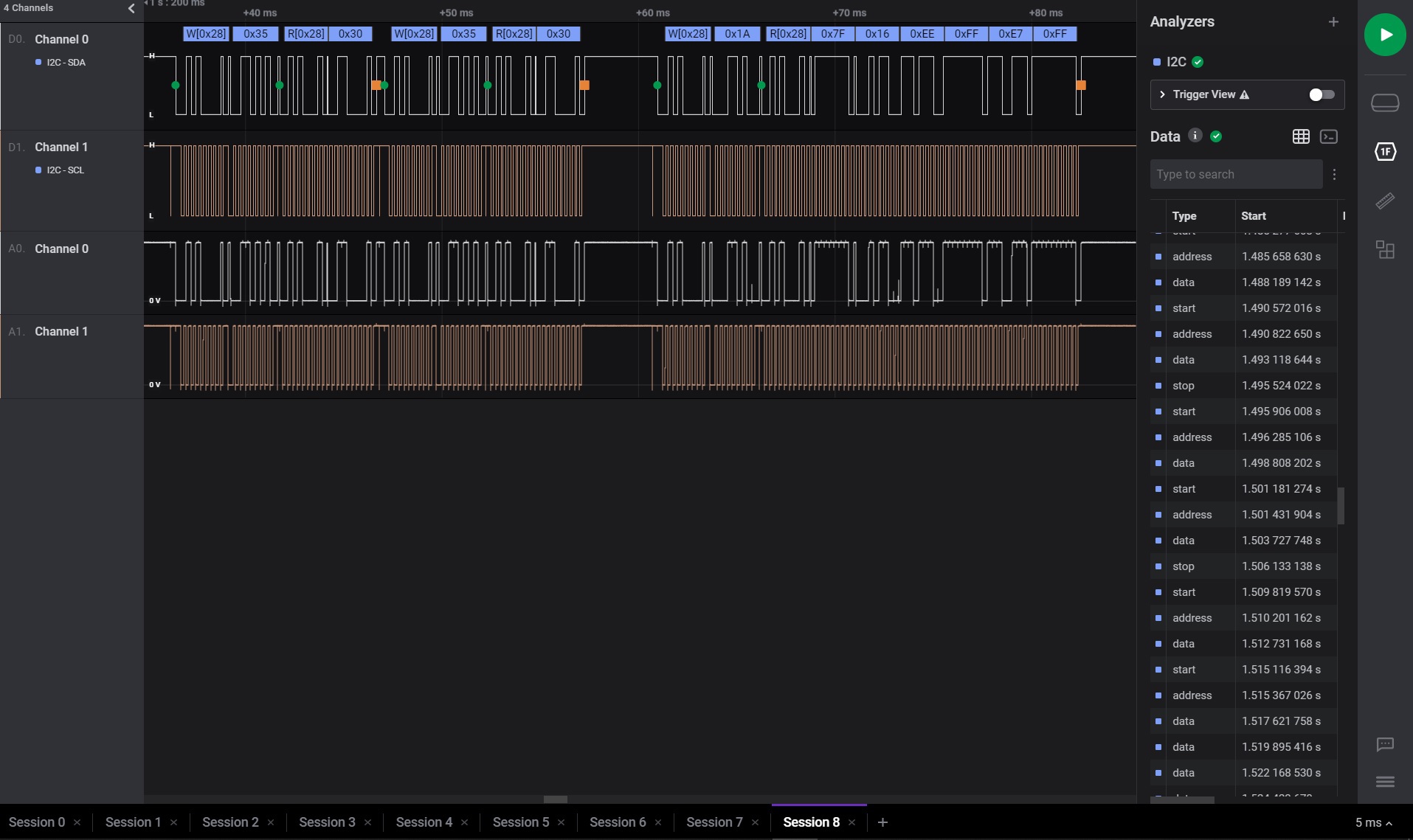

In addition, the protocol looks perfect, whether it is 4000Hz or 400kHz.
Only that the Pico freezes over 4000Hz for between 2 seconds and 2 minutes.
