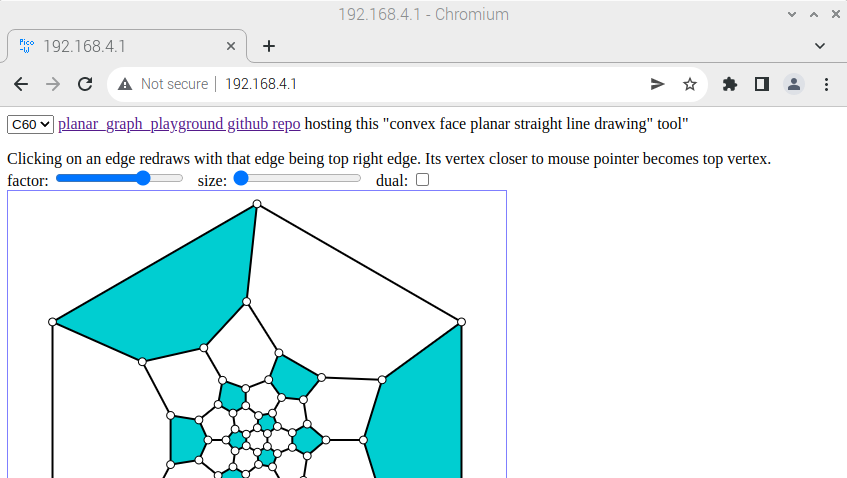

I implemented a static file webserver for the Pico-W with Pico-W MicroPython firmware:
https://forums.raspberrypi.com/viewtopi ... 8#p2017461
https://github.com/Hermann-SW/pico-w
Main demo serves my planar_graph_playground (index.html, 7 .js files and new Pico-W favicon.ico):

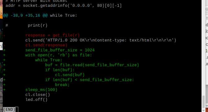

HermannSW
Posts: 197
Joined: Wed Nov 01, 2017 7:46 am
Re: Pico-W Access Point static file webserver
Post by HermannSW » Thu Jul 07, 2022 8:06 am
Thanks for that hint !
I implemented it, and for those small files I host it works.
I did ampy put a 229283 bytes file and request that via "http://192.168.4.1/Peek_2022-07-07_02-56.gif" with wget.
Seldom I got the whole size, most times a little less.
That is because "cl.close()" seems not to wait until client has received all data.
I added "sleep_ms(100)", but that does not really help.
Commenting out "cl.close()" for letting garbage collection close the socket does not work at all.
So how can I "wait until all cl.send() data was received by client", before calling "cl.close()" ?
Current main.py:
import rp2
import socket
from time import sleep_ms
ap = network.WLAN(network.AP_IF)
ap.config(essid="pico_w_ap")
ap.active(True)
led = machine.Pin('LED', machine.Pin.OUT)
led.off()
# HTTP server with socket
addr = socket.getaddrinfo('0.0.0.0', 80)[0][-1]
s = socket.socket()
s.bind(addr)
s.listen(10)
print('Listening on', addr)
# Listen for connections
    try:
        cl, addr = s.accept()
        led.on()
#        print('Client connected from', addr)
        r = str(cl.recv(1024))
#        print(r)
        r = r[r.find("/"):]
        r = r[1:r.find(" ")]
        if (r == ""):
            r = "index.html"
#        print(r)
        cl.send('HTTP/1.0 200 OK\r\nContent-type: text/html\r\n\r\n')
        send_file_buffer_size = 1024
        with open(r, 'rb') as file:
                buf = file.read(send_file_buffer_size)
                if len(buf):
                    cl.send(buf)
                if len(buf) < send_file_buffer_size:
                    break;
        sleep_ms(100)
        cl.close()
        led.off()
    except OSError as e:
        cl.close()
#        print('Connection closed')
        led.off()
