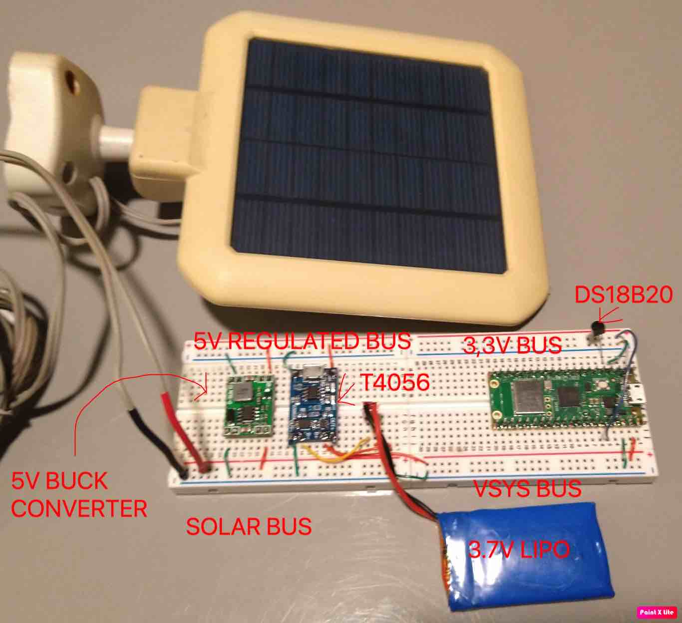

danjperron
Posts: 51
Joined: Thu Dec 27, 2018 11:38 pm
Location: Québec, Canada
Re: Pico W Micro Python MQTT of data to a RP4B
Post by danjperron » Wed Aug 17, 2022 12:21 pm
I think you'd have to identify the low power bits of the code to me before I'd have any chance of trying that out with my setup.
You could supply Vsys with a voltage bettween 1.8 to 5.5V which is perfect for a lipo battery. When the PicoW transmit via wifi it could have some peak higher than 100ma and on operation it is around 40ma but on light sleep it is around 2ma when you deinit the wifi.
The ADC3 analog pin could read Vsys Voltage via the build-in resistor divider. Then it is possible to read it. My readVsys() function.
My solar solar deliver 5V (at 0ma) and a maximum of 25ma (short). This is way not enough to run the Pico all the time. This is why I'm using he light sleep and wake the Pico to take measurement and send the info. If the battery voltage is too high I just reduce the cycle time and I discharge the battery. The same when the Voltage is going to low by increasing the cycle time.
If your solar cell is powerful enough you have no needs to modify the TP4056 pcb (unless changing the resistor which select the current of charge). If the solar cell Voltage is higher than 5V then you will need a step down regulator.
I hope that it is enough to clarify the power part.
N.B. You can't connect the usb cable if the lipo battery is connected to Vsys. You could add a diode to prevent back current but 0.7v drop will reduce the energy efficiency. ( I just removed the battery when i'm debugging with the usb cable).
Daniel

danjperron
Posts: 51
Post by danjperron » Thu Aug 18, 2022 2:18 am
Oh this sounds quite complicated.
Not at all. Solar Cell -> 5V buck converter. -> TP4056 charger -> lipo -> Pico Vsys.
This is a simple setup with a more power full solar cell.
N.B. there are two protoboards So we have four different power rails , I called them BUS, on each side.
solar to pico
Do you think there is a point in shutting down the wifi for the matter of 15 mins only to be "woken back up" again for the next data evaluation?
How would one put the wifi to sleep and wake it back up again in between measurement cycles?
If you look at my script it does exactly that.
Inside the loop
- initialize the wifi
- read the sensors
- send the mqtt data
- close and deinit the wifi
- goto lightsleep for n seconds until next loop.
