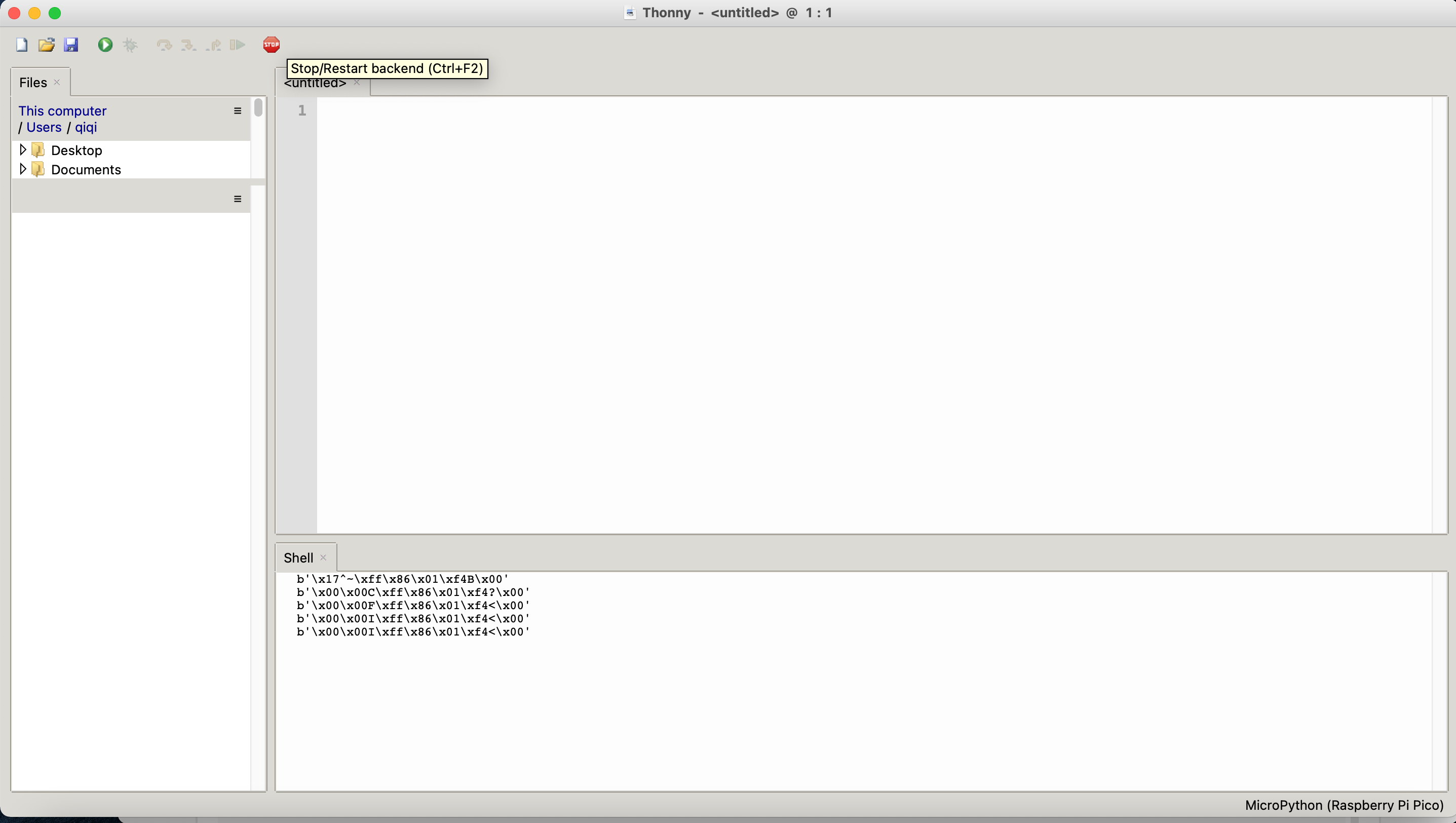

Thanks for your suggestion! I tried it.
Unfortunately I still get sensor reading with totally unusable bytes (the length of 9 bytes is correct), if I connect the board to external USB power source.
I added a print command to print out the raw sensor reading and added two screenshots. The first one shows the results by running the program in IDE. The second one shows the results if I just connect the board to computer USB to trigger automatic run of main.py. You can see the difference of sensor reading pattern.
Re: Problem with UART reading (MH-Z19B sensor)
Post by Roberthh » Sun May 23, 2021 8:02 pm
Thats' strange. If you are always have three extra bytes upfront, you could try for read 12 byte and discard the first three.
B.T.W.: Which version of the firmware do you use?
Edit: I would move the clearing of the input buffer INTO the loop before you send a command. Then any remainder of a previous possibly failed transmission is gone.
