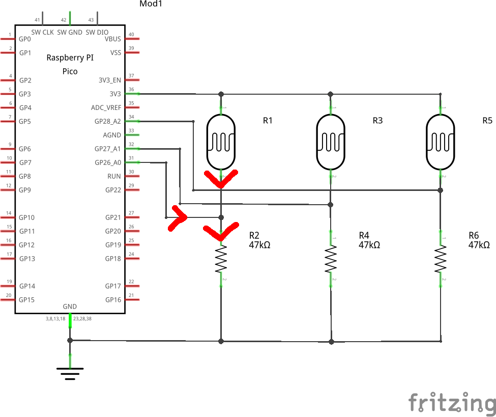

Are you looking for something like that?

Yes thanks, but how do I get the photocell's resistance ? Can the pico get the current so I can use Ohm's law ?
Re: photocells get light intensity
Post by Roberthh » Fri Nov 19, 2021 8:03 am
The pico can measure the voltage, and from that and the known value of the other resistor you can determine the value of the light cell.

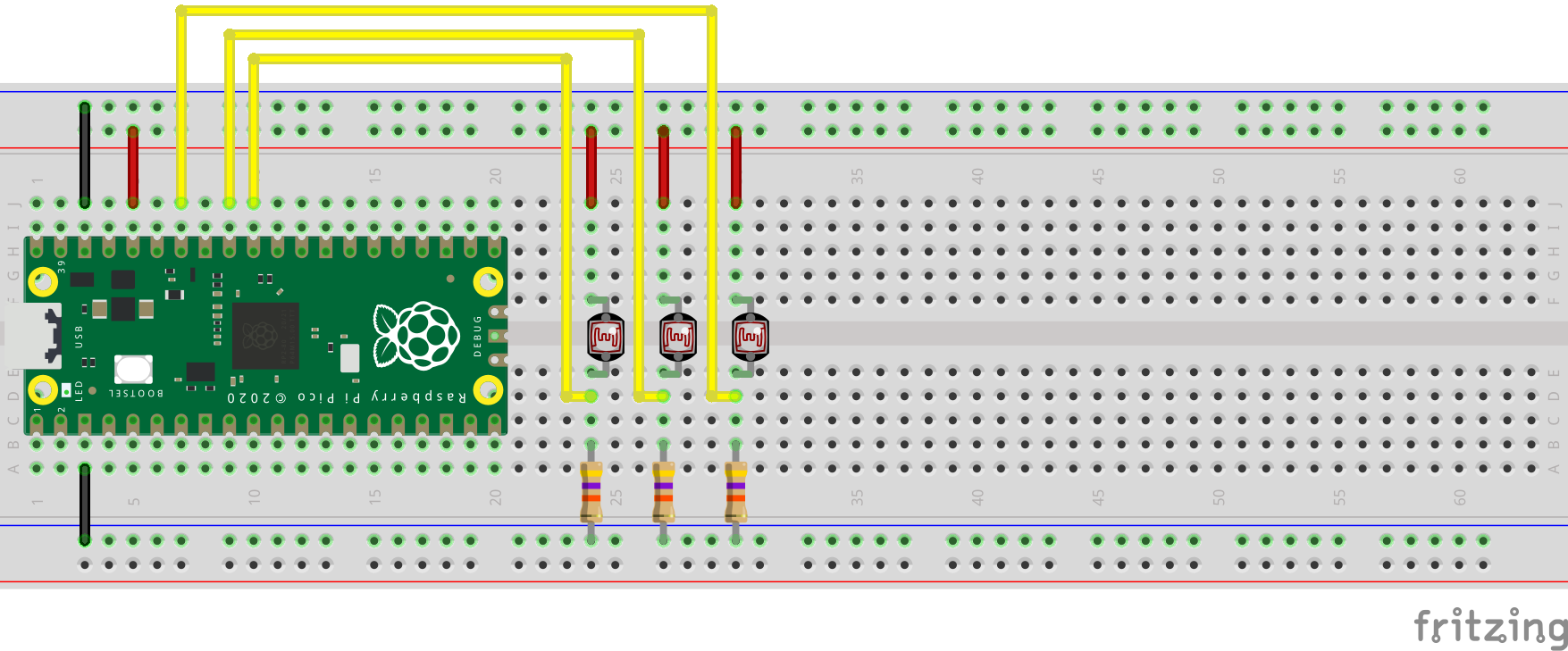

Based on proposed schematic, you can read photocells with this code.
from machine import Pin, ADC
# Set sensors
sensor_a = ADC(Pin(26))  # ADC0
sensor_b = ADC(Pin(27))  # ADC1
sensor_c = ADC(Pin(28))  # ADC2
# Read sensors
# read value, 0-65535 across voltage range 0.0v - 3.3v
sensor_a.read_u16()
sensor_b.read_u16()
sensor_c.read_u16()

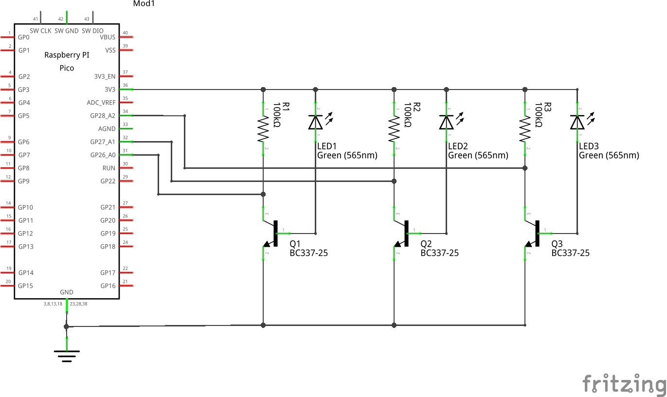

An other approach, would consist of using an LED as a light sensor, amplified by a transistor.

Last question, I want to apply Millman to get R1 for example, is the current running in this direction ?
And is the current coming from 31 negligible ?

You can consider GP26_A0 as an high impedance, so current iGP26_A0 can be considered as 0A.

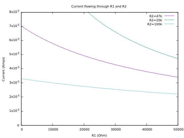

Current iR1 = iR2. As R1 depend on light, i = 3.3V / (R1 + R2), so i is not constant.
Example with different value for R2
