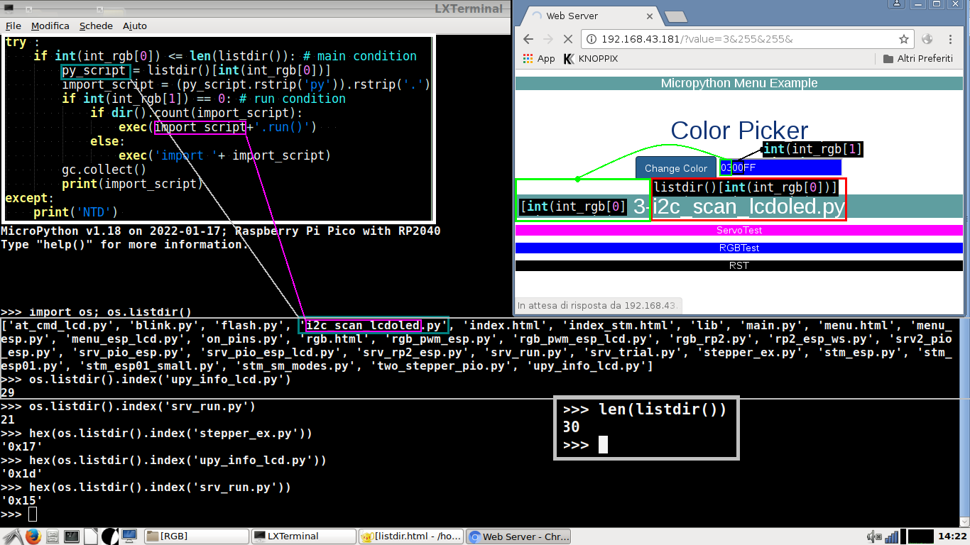

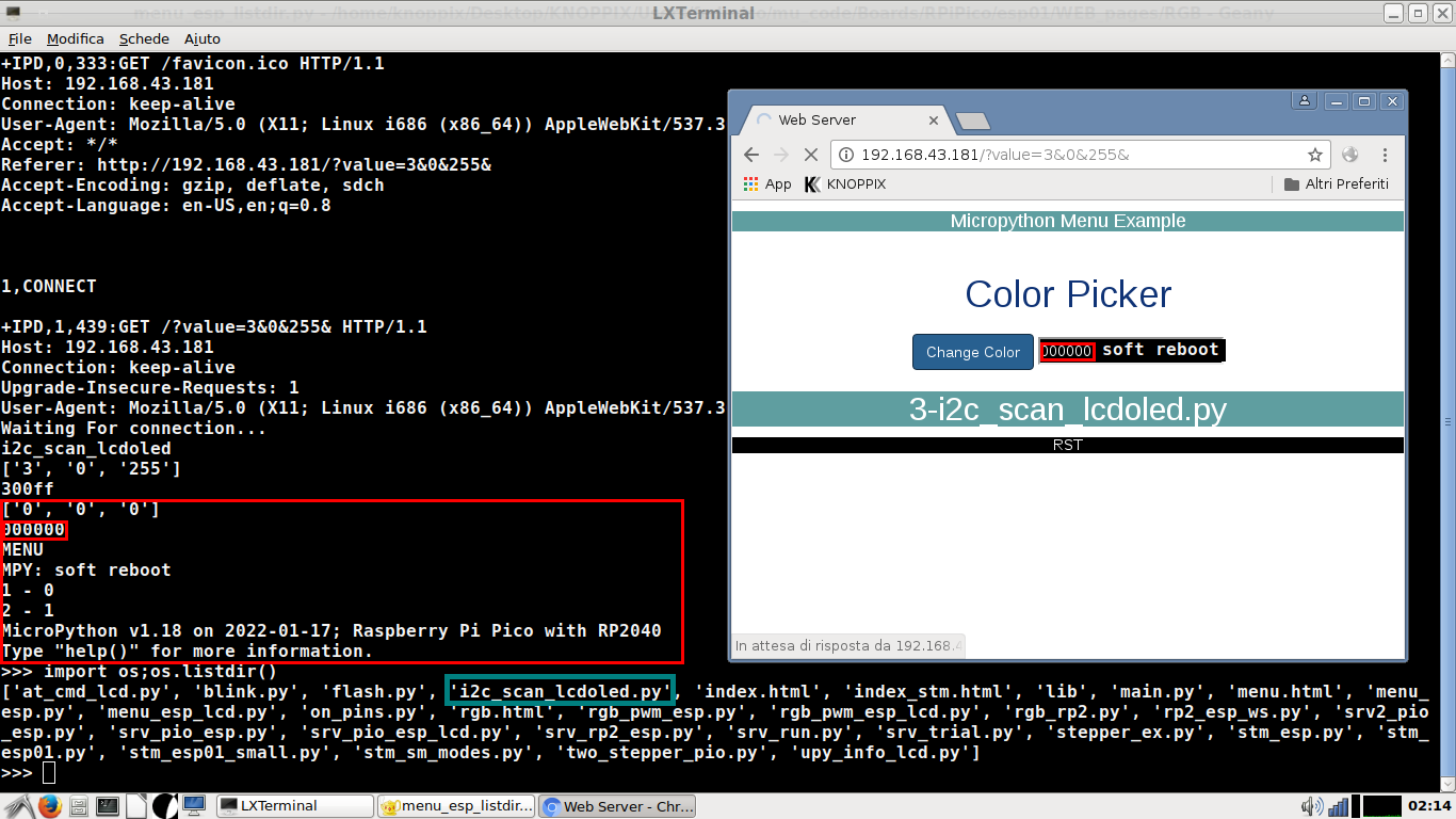

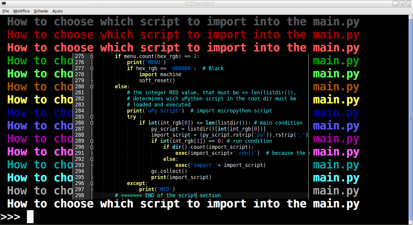

Hoping to be of some help-
Time ago, I have faced the need of how to choose wich micropython (example to run) script to import at runtime inside the main.py file.
The following is the WEB Server solution (*) which uses a Color Picker to choose the micropython script.
The code depends on the ESP-01S board used to add WiFi connectivity to the Raspberry Pi Pico. Clearly, "mutatis mutandi", with the new Pico W card the code will be simplified and no additional wiring will be required.
Coming to the code, the main work depends on the values of the R and G colors.
The two bytes of RED are used to select the number of the script (in the micropython listdir ()) that will be used in the string of the import statement in main.py
For example, if we enter the hexadecimal value "0E" (dec 15), this means that the file listdir () [15] will be imported - in listdir () [15] it matches the string of the micropython file, for example:
'rgb_rp2.py'. From this string, by cutting the end ".py" we build a new string "import rgb_rp2" which will become the argument of the exec instruction.
exec ('import rgb_rp2')
On the browser WEB page , we check if the file name is the one that we want to be imported, and if all is OK we proceed by retyping the file number "0E" followed by the "00" ( the Green two bytes) which will confirm the execution of the micropython's import instruction. ( see the code )
The RGB "000000" value is used in the example code only to make a reboot of the board.
If you need to choose between a small range of micropython files see the (**) about the Micropython Menu WEB Server where the code is simplified .
Hoping to make the things easier, see the pictures.

- Micropython Scripts in the cwd
- root_dir.png (180.44 KiB) Viewed 7031 times
- How to import
- how_to_load_and_run_a_script.png (185.83 KiB) Viewed 7031 times
- How to choose
- how_to_choose.png (217.29 KiB) Viewed 7031 times
