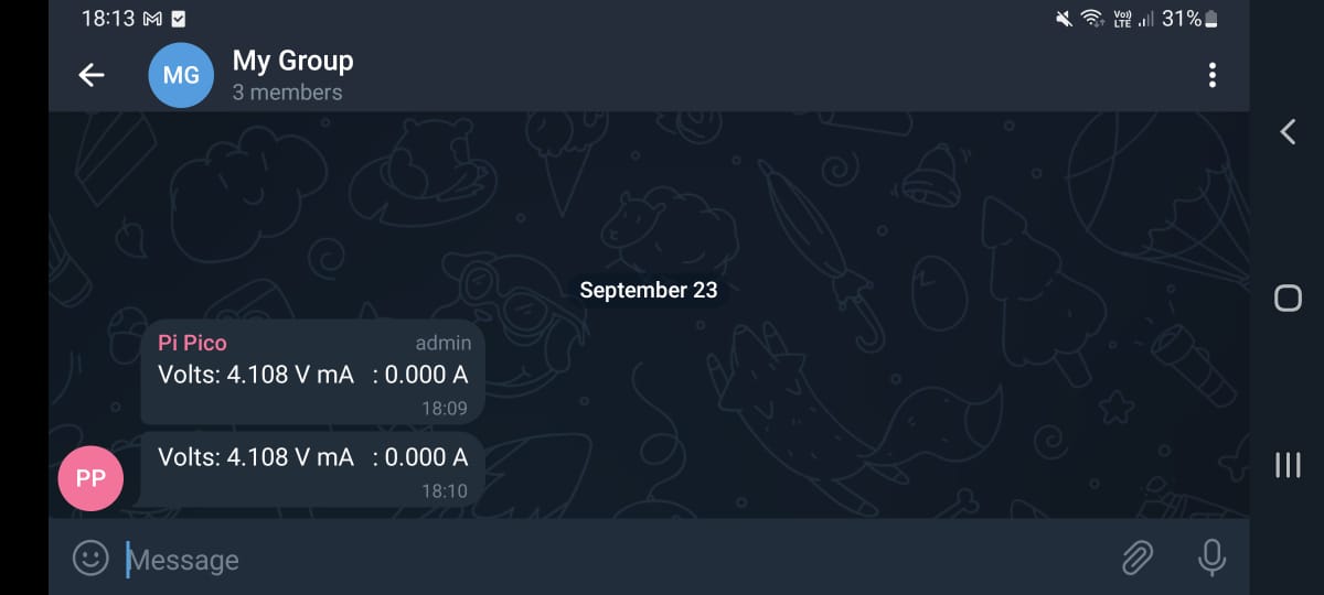

But soon realised afterwards I could send INA219 data directly to a Telegram Group via the online Telegram Bot from my
scrappy example code, but with no control yet... :)
response = urequests.post('https://api.telegram.org/bot<YOUR API KEY>/sendMessage?chat_id=-<YOUR GROUP CHAT ID>&text=' + "Volts:{:6.3f} V".format(bus_voltage) + " mA   :{:6.3f} A".format(current/1000))
response.close()
