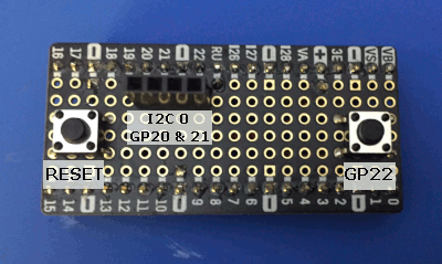

I picked up one of these https://shop.pimoroni.com/products/pico-omnibus and a couple of these https://shop.pimoroni.com/products/pico-proto to use with my Pico.
A couple of buttons and a 4-way I2C connector later . . .
. . . and I have a ‘reset’ button, a general purpose button and a place to put my 128x64 OLED display
Plus, the option to fit it directly to the back of the Pico, if required
