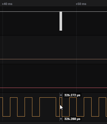

I could reproduce this and it seems indeed the square wave that gets distorted at the time when the PIO starts the measurement.
For debugging I added a sidestep that toggles a pin while the measurement was active:
    label('low_high')
    jmp(x_dec, 'next')  .side(0)
    label('next')
    jmp(pin, 'low_high')  .side(1) # while pin is high
sm0 = rp2.StateMachine(0, mark, freq=1000000, in_base=pin16, jmp_pin=pin16, sideset_base=Pin(2))
On the saleae it showed the following: (see attachment, top is the pin toggling of the sidestep). You can see that during the meassurement time, the pulse is distorted, resulting in the wrong value. But the actual measurement is perfect (toggling of pulses start at the rising edge of the input and end at the falling edge).

So the issue is likely that the Timer's Irq callback is delayed when the foreground is active.

Thank you :!: All my scripts now work with superb accuracy.
Apologies to @cebersp who first suggested using PWM - I was relying on an oscilloscope view of the square wave which missed the rare corruption. As a PIO n00b I assumed I must be doing something stupid...
marfis wrote:
Tue Feb 23, 2021 8:47 pm
I could reproduce this and it seems indeed the square wave that gets distorted at the time when the PIO starts the measurement...
So there is a firmware bug which should be reported. Do you want to do this as you have gathered the definitive evidence?

I tried this script which produced some odd results:
from machine import Pin, Timer
from time import sleep_ms
import math
pin17 = Pin(17, Pin.OUT)
tim = Timer(freq=1000, mode=Timer.PERIODIC, callback=lambda _: pin17(not pin17()))
pin18 = Pin(18, Pin.OUT)
    pin18(1)  # Trigger
    pin18(0)
    y = 0
    for x in range(100):
        y += math.sin(x * 2 * math.pi/100)  # 6.2ms of busywork
    sleep_ms(100)
Two issues: firstly it doesn't run for more than a few minutes before the waveforms stop. It's not a complete crash: ctrl-c gets the REPL back. I found my original scripts also stopped after a while.
Secondly the timer pulse durations vary, occasionally quite radically. But it can take quite a few single shot readings to spot this. Maybe it's only certain types of busy work which affect the timer?
