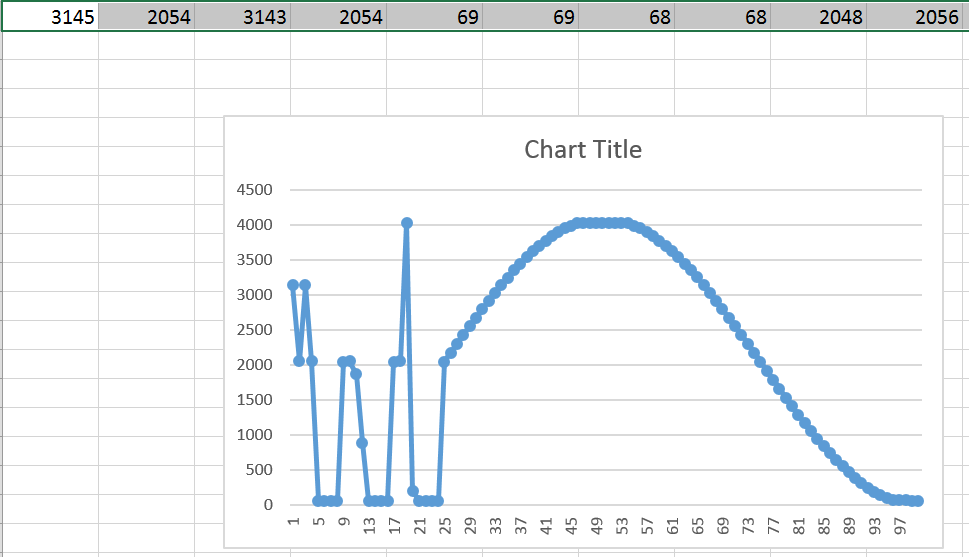

I *think* I have a working version of DAC.write_timed() which supports
12 bit resolution (currently hard-coded).
So I set out to test it:
# place jumper between X6 and X19
import array
import math
a = pyb.ADC(pyb.Pin.board.X19)
d = pyb.DAC(2)
# sine wave output buffer
b = array.array('H', [0]*100)
for i in range(len(b)):
    b[i] = 2048 + int(2047 * math.sin(2 * math.pi * i / len(b)))
# sampling buffer for one period of the signal
# we A/D convert w/ 'osr' times oversampling
osr = 1
s = array.array('H', [0]*osr*len(b))
# frequency
f = 10
# output sine wave at 10Hz
d.write_timed(b, f*len(b), mode=pyb.DAC.CIRCULAR)
# sample the sine wave with osr values per sine value
a.read_timed(s, f*len(s))
In short: I sample the generated wave form with one of the ADC pins.
I have provisions for a variable oversampling ratio but for the sake of
demonstration I set osr=1. What I would expect is an approximation of
the generated waveform which is phase-shifted because the DAC and
ADC are not triggered at the same time. What I get instead is a *partial* waveform like in
the attachment. I first thought that perhaps the DAC in circular mode
needs some time to jump back to the beginning of the buffer but this
seemed a bit unlikely. Then I went ahead and studied the code in
adc.c and lo and behold it seems to use the same TIM6 timer like
in the DAC.write_timed() implementation.
I will go back and flash a official firmware and redo that experiment
with the unmodified 8bit DAC but I am pretty sure right now one can
not use the timed functionality of ADC and DAC in parallel.

well, I reflashed the original firmware from 18-FEB-2015 and
ran this code:
import array
import math
d = pyb.DAC(2)
#b = array.array('H', [0]*100)
b = bytearray(100)
#    b[i] = 2048 + int(2047 * math.sin(2 * math.pi * i / len(b)))
    b[i] = 128 + int(127 * math.sin(2 * math.pi * i / len(b)))
# we ADC w/ 'osr' times oversampling
osr = 1
# frequency
f = 10
This gives me a reasonable captured wave form like in
the attachment. I still think using the same timer TIM6
for ADC and DAC is a problem but it is not a straightforward
explanation for the garbled waveforms I captured with
my modified firmware ...

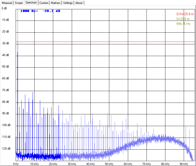

I went ahead and measured the DAC output spectrum of the unmodified MicroPython firmware. Setup is a Steinberg UR22 on the PyBoard pin X6, software is AudioMeter v. 3.6.1. I generated a 1kHz sine wave with the code from my previous post. The screenshot shows the output spectrum with lots of harmonics which are 45dBc and less. This is not stellar but in the ball park range for a 8bit DAC.
However as soon as I issue a
ADC.read_timed()
on pin X19 (no jumper between X6 and X19) the signal from X6 is gone.
I consider the usage of the same timer TIM6 to be the problem here. I want to see if I can change DAC.c such that it works with timer 7 instead of timer 6 and see if that fixes the problem.
