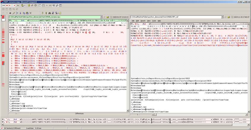

Post by BramPeeters » Tue Jan 07, 2020 3:10 pm
Sadly fixing the name difference does not make the result equal (the names are the same now, i put an empty filename in the host cross compiler.
Eg in the first bytes there are already differences (I have added image with birds eye view of differences)
mpy-cross: 4D 03 02 1F AF 16 28 02 00 00 00 00 83 65 34 00
on target : 4D 03 02 1F AE 3D 28 02 00 00 00 00 83 62 23 00
So i probably have different settings.
Using sys_mpy = sys.implementation.mpy as in the page you linked does not work because 1.9.3 does not yet have support for this attribute.
Any idea how to configure these things in the xcompiler ? I just spend some time trying to match the parameters in mpconfigport.h but
