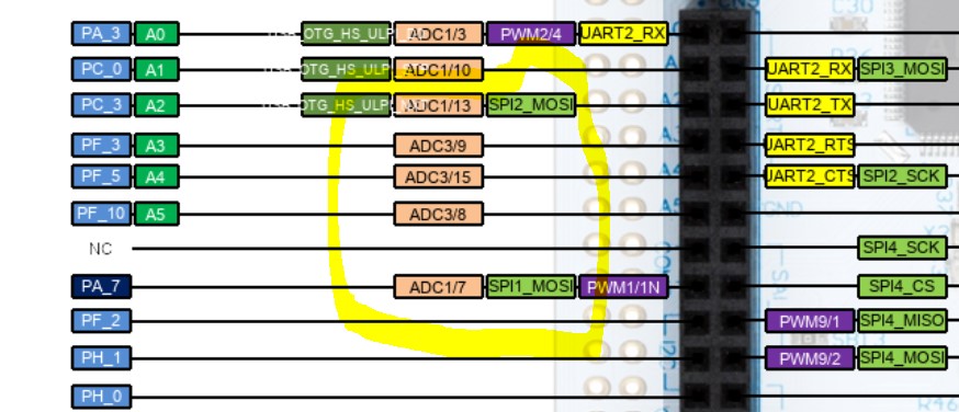

Why isn't possible to run ADC on some pins in the yellow ring on the picture, but different pins yes?
In the datasheet, it should work.
Is it possible to repair it in firmware?
#F3=pyb.ADC('PF3') #A3
#F5=pyb.ADC('PF5') #A4
#F10=pyb.ADC('PF10')#A5
  File "<stdin>", line 18, in <module>
ValueError: pin F3 does not have ADC capabilities
And why the pyb library does not contain DAC?
Thank you for your responses.
