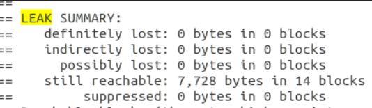

I'm currently building MP as a library based off the minimal build linked into a linux application. I would like to use a dynamically allocated heap as follows
//#define MP_USE_MALLOC_HEAP
#ifdef MP_USE_MALLOC_HEAP
static char* mp_heap;
#else
static char mp_heap[PYTHON_HEAP_SIZE];					// Micropython's heap
#endif
mp_heap = (char*)malloc(PYTHON_HEAP_SIZE);
#endif
mp_stack_ctrl_init();
gc_init(mp_heap, mp_heap + PYTHON_HEAP_SIZE);
mp_init();
When I test with Valgrind I'm getting the following results:
Built time heap

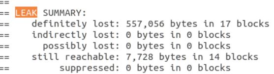

Malloc runtime heap
Anyone have any ideas as to why am I getting more memory leak from the dynamically allocated heap?

There's a malloc() for mp_heap but code shows no call to free(), hence it's a leak? That, or valgrind is incorrectly reporting the static memory as leaked.
