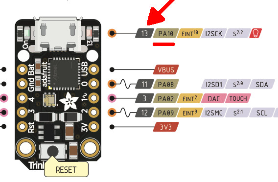

Definition for Trinket M0
However, on the Trinket M0, the LED (wired to PA10) is labelled as Pin #13.
So the machine_pin_obj should be deifined in such a way to have the 13th position associated to PIN_PA10.
This will ONLY covers the Trinket M0 use-case. The feather M0 or ItsyBitsy M0 or Gemma M0 will have a different definition of machine_pin_obj because of different MCU pin assignment on the board.

The Pin 13 definition is left over from Arduino days, when pin 13 was always the LED pin
