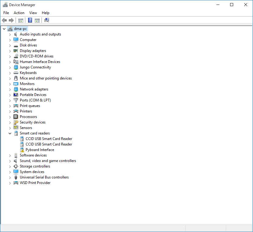

i have just completed the implementation of the module Smart cards and usb CCID driver.
The result is this:
In use:
For use it i have implemented new usb_mode:
pyb.usb_mode('CCID')

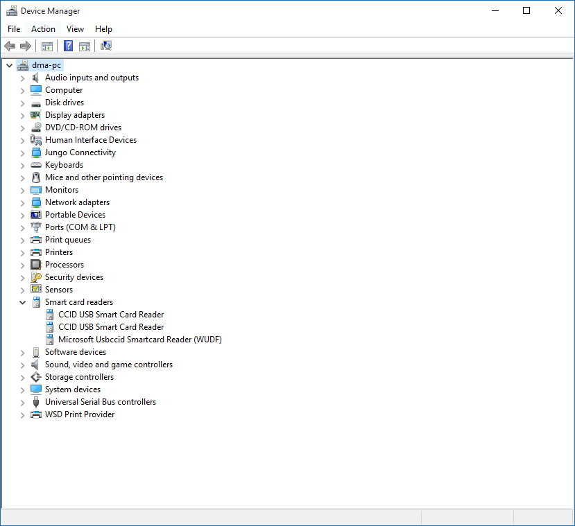

Windows usb CCID driver:

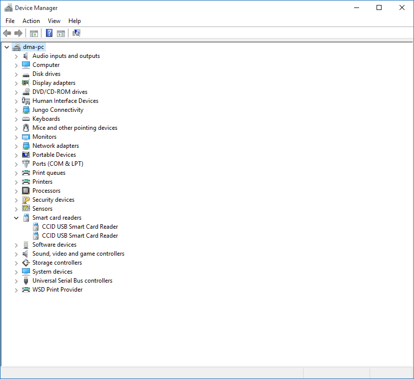

In CDC mode:

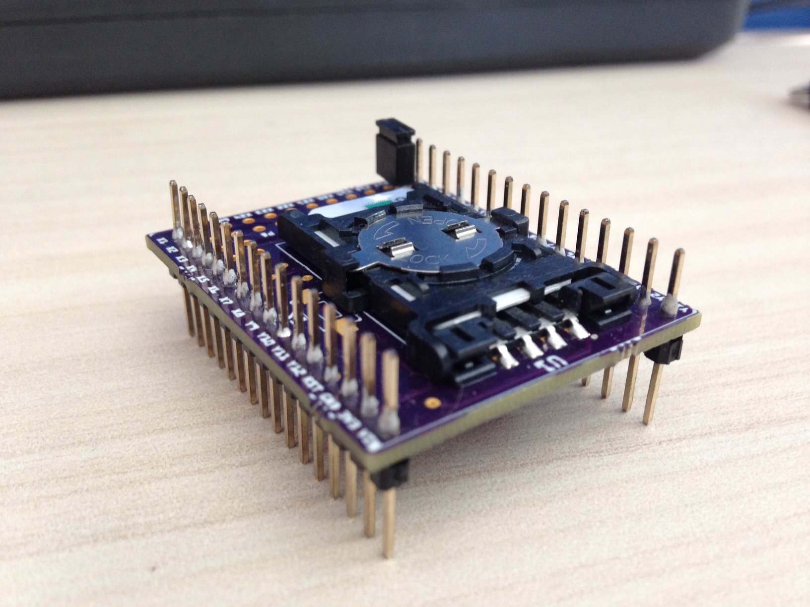

In normal use case:

Dear pagano,
This is interesting. Is such a board available? I would very much like to play with the smartcard function of the controller.
Regards,
Roland
pagano.paganino
Posts: 89
Joined: Fri Sep 11, 2015 10:47 pm
Location: Italy
Re: Smart Card and CCID driver
Post by pagano.paganino » Wed Jan 27, 2016 10:47 pm
Hi Roland,
thank you for your interest.
At the moment I do not have available pcb, is a prototype.
But aside the pcb I haven't released and I still don't know when and if they release the source code of the module SMARTCARD.
Best regards,
