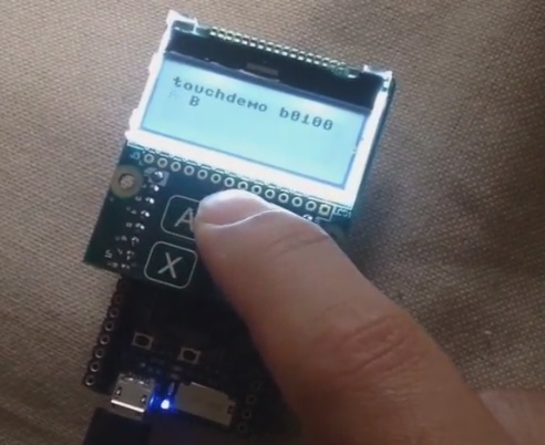

Video on http://instagram.com/p/p0hAeuzfqS/?modal=true
touchdemo
polygontwist
Posts: 36
Joined: Sat Jun 28, 2014 4:54 pm
Location: Germany, Rostock
Re: LCD Touch Demo
Post by polygontwist » Sun Jun 29, 2014 4:17 pm
with drawFillRect-fuction, Accelerator, blue LED and handling Exceptions.
my Exeption is "Exception: HAL_I2C_Mem_Read failed with code 3". With this code continues to operate the program.
