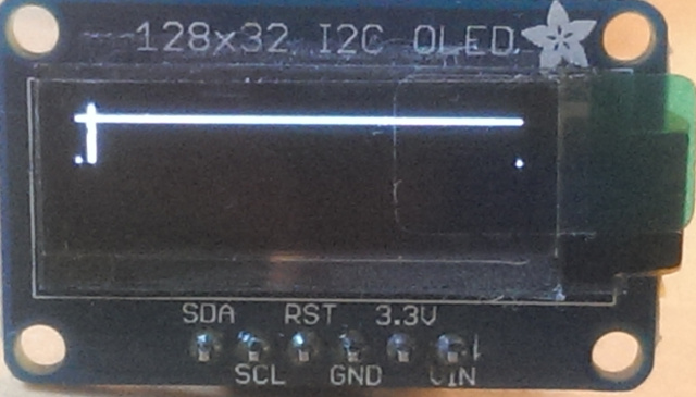

Re: OLED Displays SSD1306
On my 128x32 pixel display this library does not work as intended...
The height of 32 pixels does not seem to be taken into account correctly. Every second line seems to be skipped from the buffer, starting at the missing lin 0. Or at least something like that. The drawable region is only 16 pixels high and offset by 16 from the bottom of the display (at least from my point of view; correct physical orientation can be derived from my attached photos).
In my photos you can see your original example from github (matched to 32 instead of 64 pixel height) and an example with the following drawing operations only:
for x in range(128):
display.set_pixel(x, x % 32, True)
- my_example.jpg (79.42 KiB) Viewed 23198 times
- orig_example.jpg (86.94 KiB) Viewed 23198 times
Stupid, was my fault. I did miss line where you do set the height of 64 pixels in the call to the constructor of the SSD1306 object.
