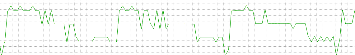

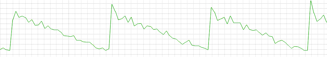

Here is the graphs usage of each one :
pi :
esp8266 :
The line is quite smoother on the pi.
