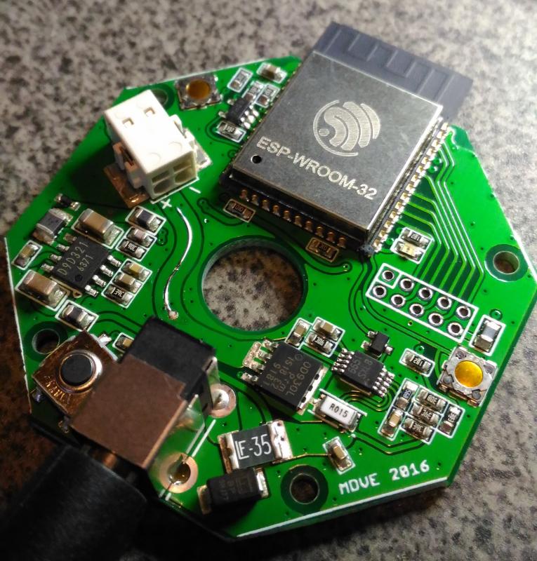

The other lamp controller works well enough I tried one with the new ESP32 module. I just melted this up in my toaster, eyeballed the connections, soldered on a power connector, *crossed my fingers*, and plugged it in. Hungry little guy is now broadcasting "FEED ME" on all wifi channels and Bluetooth. I think it's Pycom compatible, I'm going to try and flash Micropython 1.8.6.
that's a TPS25069, BD9D321, and a 8Kx8 serial flash chip next to the ESP32. The little dimples are reset and boot switches. This will control a custom aluminum 'chip-on-board' module with about 20 watts worth of LEDs.

Not taking Pycom, it boot loops aparently due to not having QIO flash. I did have some luck with Pumbaa through Ar(gh!)duino.
