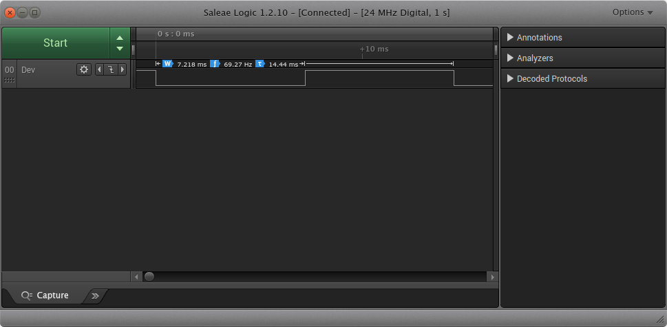

When I tried, MicroPython picked a prescaler of 29 and period of 40403. (168000000 / 30) / 40404 = 138.6001386 (which is the toggle frequency) Dividing by 2, we get the full cycle frequency of 69.3000693 Hz.
In either, case I see this output on pin Y6:
