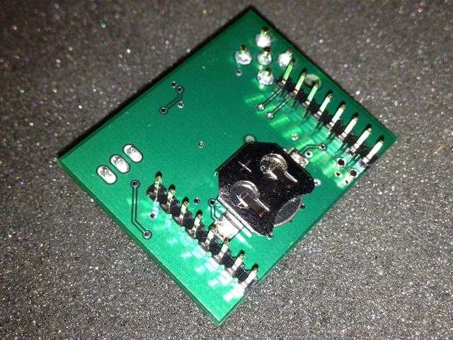

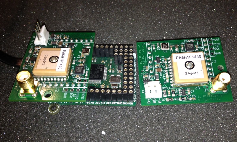

First two navigation boards have been built and partially tested - I apologize for the poor lighting:
Thanks to the libraries provided by @Turbinenreiter I can confirm that the BMP180 barometric altimeter and MPU-9150 IMU appear to work as they should. The GPS unit can receive a signal from either its own patch antenna or from an external antenna via the SMA connector. I do not have a lithium battery pack or appropriate high-current load so I have not yet fully tested the battery voltage and current monitoring circuits; I intend to get to that soon.
On issue that i discovered today (and probably should have thought to check sooner) is that the GPS module contains a fairly large amount of ferromagnetic material, presumably in the RF shielding. The IMU with its magnetometer is extremely close to the GPS unit, and magnetic measurements may be adversely impacted by this proximity. I have some idea how to determine whether this will actually be a problem, but I would also welcome any suggestions on how I might check this.

pythoncoder wrote:The MPU9150 and its driver produce calibrated magnetometer readings.
This is the assumption that I had started with. After discovering that the GPS modules had a substantial amount of ferromagnetic shielding, (which I might have noticed before doing the layout…) I assembled the first two units with the GPS module and had a period of minor panic / disappointment when I found that the magnetic readings were not centered on zero. I expected that turning the unit 180 degrees around any axis would simply reverse the sign of 2 out of 3 magnetic components; in actual testing the measured values would reverse, but the mean value had some offset from zero on each axis. I attributed this to the field contributed by the GPS module, but then I built a board with just the MPU9150 to check. Without the influence of the GPS module, x and y are reasonably well balanced, but there is still a large offset on the z-axis.
To do this testing you need to be sure you're free of local magnetic fields caused by electrical equipment or ferrous objects. Ideally do the testing outdoors. Failing that a check with a compass will show if there are any major local influences.
For now I am doing my testing inside; I don't plan to spend much time sitting in an open field with my laptop until average temperatures return to well above freezing ;)
If the GPS module is causing problems I wonder if it would be feasible to degauss them before assembly onto the PCB?
I expect that this would be pretty challenging; I'm certainly not equipped to do it for a desktop assembly. Actually I anticipate that the offset will need to be compensated through a calibration procedure, which could also help to mitigate any contribution from a lithium battery pack (which tend to be somewhat ferromagnetic as well).
I did a quick search for quaternion sensor fusion routines written in Python; while I didn't find exactly that, I did stumble across this project which could be quite helpful as it supports the MPU9150 as well as several over IMU systems. Relevant to this discussion is the note regarding magnetometer calibration
At any rate I will take care to put more separation between the GPS module and the MPU9150 in my next revision of the board, but I'm not convinced that we will ever be able to completely eliminate the need for magnetometer calibration.

dhylands wrote:The large Z component is typical depending on where you are.
There is in fact a fairly large Z component to the field that I measure (~45 uT in vertical component versus ~10uT horizontal) but that isn't the issue that I am referring to. The vertical component is large no matter which magnetometer axis is oriented vertically.
The issue here is that there is actually a large offset in the Z-axis measurement of the magnetometer, such that I get Z readings of -6 to -8 uT if the board is sitting flat on my desk, and +87 to +89 uT if I flip it upside down. The X and Y axes can measure the large Z field component if I turn the board on its edges, but without the ~35uT offset (I'm just doing an eyeball average for these readings.)
It is this offset that will need to be calibrated away for decent sensor fusion performance. Given that this seems to be inherent to the sensor, and the library I linked to has a pretty decent 3D magnetometer calibration routine, I'm not going to worry too much for now about the field offset introduced by the GPS module. I'll try to reduce it with some more distance if I do another board rev, but I think that with calibration this current version will work fine.
