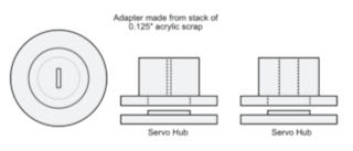

The unit mounted to the door replaces the thumbscrew and is attached with the same two screws. On the outer surface is a standard size R/C servo. Inside is a Raspberry Pi PicoW, a TBD lipo battery and charger, and various acrylic and metal servo parts.

1 ea custom laser-cut acrylic servo to deadbolt actuator
Servo to deadbolt actuator adapter
