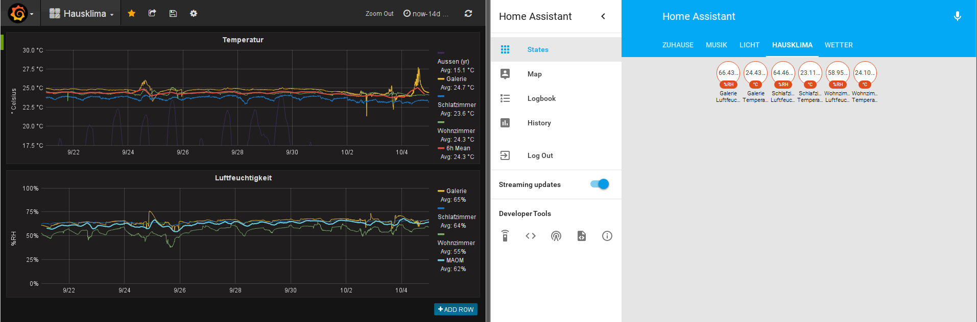

As you mentioned "visualizers" in your initial post. This is the my most viewed page in my smart home. The sensor nodes on the left are of course ESP8266 MicroPython nodes publishing to a Mosquitto MQTT broker, where my Home-Assistant fetches the values from. Home-Assistant also transforms the payload and pushes it onto my InfluxDB, where I use Grafana to paint graphs of them.
(yes, i know we need to air our house asap. We own a passive house and i need to switch on the automatic venting system again. This is my direct motivation for this visulization, btw ;) )

Home-Assistant also transforms the payload and pushes it onto my InfluxDB, where I use Grafana to paint graphs of them.Grafana+HomeAssistant.png

Grafana is just "The leading tool for querying and visualizing time series and metrics" as they describe on their homepage.
Are you satisfied with Home-Assistant? I still have problems to understand the concept.
I did set it up ony a few months back. Personally i am also not crazy in love with the whole home automation stuff. Just got in touch with it while connecting Philips Hue light bulbs with my home network and wanting to control them without the vendor tools.
At the beginning i got confused with the different entity ids in the internal inventory of Home Assistant. Especially locating the entities for use in the configuration file was not very self-explanatory (maybe i should have put more focus on reading their documentation). What i got used to was checking the known entities in the web UI at the URL path '/dev-state'. There you can find all entities by the correct name (light bulbs, streaming boxes and sensor nodes in my case).
As already mentioned, basically i did start using Home Assistant as a MQTT -> InfluxDB bridge and am now discovering all its other use-cases.
