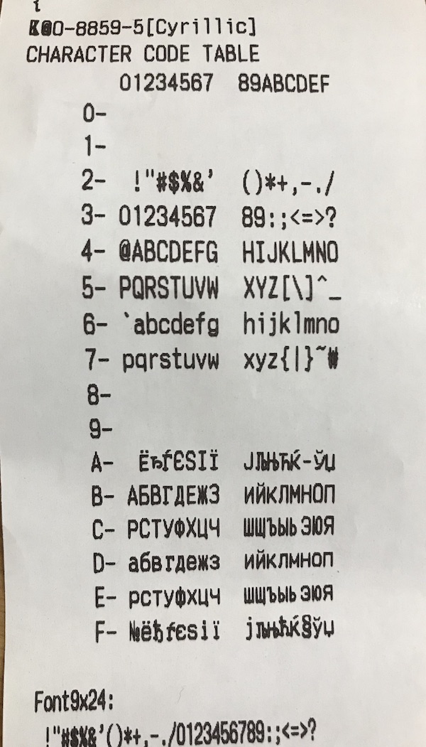

I'm trying ti get this thermal printer working but I fail to get the right codepage conversion.
I think the key is converting the UTF-8 bytearray into a codepage the printer recognises. Here is a self-test printout showing the active codepage iso-8852-5 along with the charset table. I try to pass via uart.write() to the printer following string "АБВГ". As it's utf-8, I need to convert it to the printer active codepage. I'm trying with:
and the result is "\xd0\x90\xd0\x91\xd0\x92\xd0\x93"
May be I'm using he docs in a wrong way? Here's the source: https://docs.micropython.org/en/latest/ ... html#bytes
However if I manually find the bytes in the charset (see printout above):
"\xb0\xb1\xb2\xb3"
and pass it to the printer on the UART, it prints the correct characters. This makes me think that the conversion function is wrong.
Any ideas why?
bytes('АБВГ', 'ISO-8852-5')
"\xb0\xb1\xb2\xb3"
Any ideas why?
