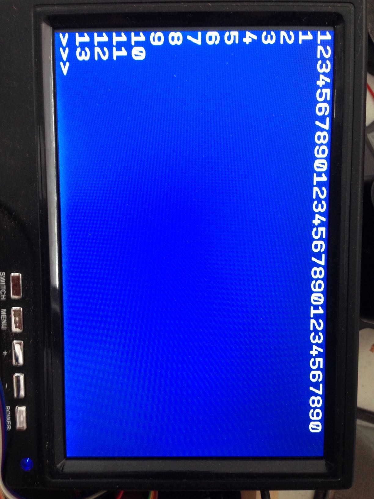

I have developed what I call a SuperPyBoard. It is a board for the pyboard that lets you have a high resolution VGA monitor connected to the pyboard with a UART. This frees up the pyboard to do what you really want it to do without spending a lot of time refreshing a display. Send out the character at 9600 baud and the external circuitry handles the display. It also incorporates a PS2 keyboard port that allows data to be entered in an embedded application.
The VGA display can be made into a 32 line by 80 character high resolution display, or change the software and it becomes a 14 x 32 character display with big characters that can be read from a long distance. I am currently running it on a 7" display from Adafruit, and the low resolution characters are 5mm tall, with highly visible white characters on a blue background.

I have some pictures that show both the high resolution displays and the high resolution display. Also, you can get a pic of the circuit board I have had made. I can't figure out how to get them pasted into this message on the forum. I will send them to anyone who contacts me on outdoorman25@gmail.com.
- Low Res Display.jpg (206.97 KiB) Viewed 13530 times

Looks like my two attempts were somewhat successful. Here is the high res display

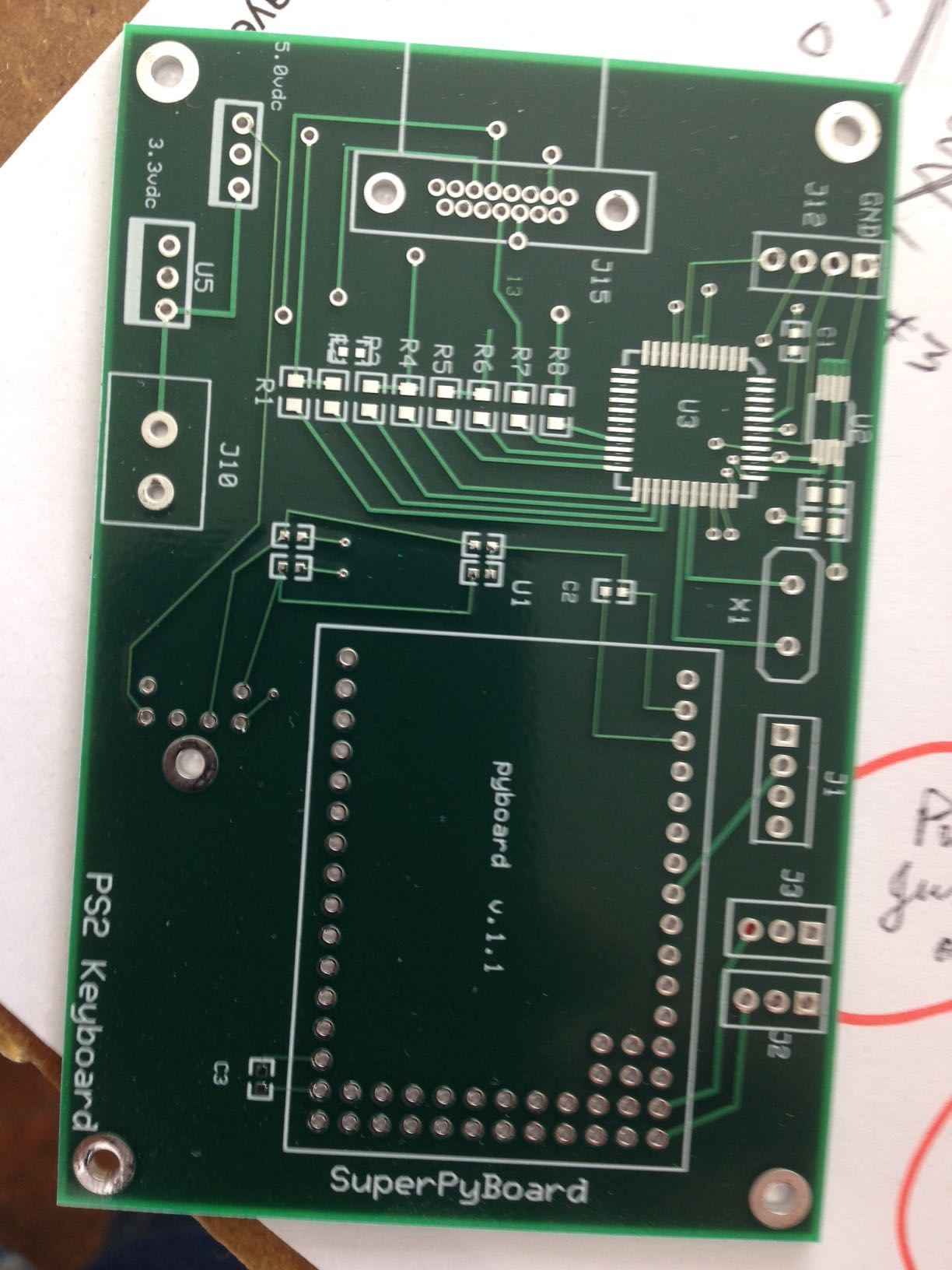

Here is the circuit board. I am waiting for my pyboard from Adafruit.

I just completed the cursor positioning and screen clear in uPython. I also have an expansion board made up for it so it can stack on top or bottom of the SuperPyBoard.
