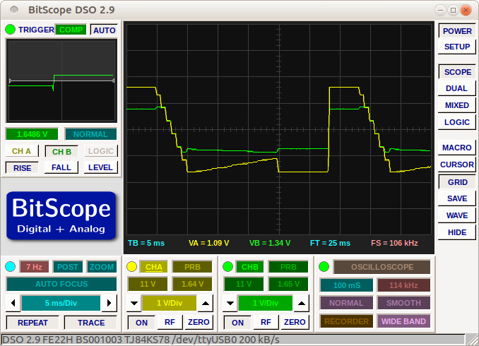

Re: opposite polarities on the 2 DACs
Hi Peter,
Some news:
just reading the DAC registers with stm.mem32 changed the results !!!
the files are in https://www.proximuscloud.be/web/app/sh ... pijdmt6mbj
The 2 signals are (almost) as expected, but DAC 2 seems to use the analog buffer and has a reduced voltage.
Only explanation is that I have a pyboard with a Qubit.
Somebody replaced a good old normal 0/1 bit with a Qubit that can change value when reading it.
(beware theoretical physicists !)
Andre
Some news:
Andre
Hi Peter and chuckbook,
I turned output buffering off with
and it worked.
See RM0090 Reference manual
www.st.com/resource/en/reference_manual/dm00031020.pdf
Digital-to-analog converter (DAC) chapter 14 page 433
DAC_CR = 0x40007400
BOFF2 = 0x00020000
stm.mem32[DAC_CR] = stm.mem32[DAC_CR] | BOFF2
Most likely the buffer op-amp of the port is damaged. This would explain the symptoms.
According to the sparse documentation of chip internals the output op-amp is indeed inverting and the DAC output is also (digital) inverted
if buffer mode is selected. So if the op-amp is broken an inverted (and probably reduced) voltage would be seen on the output pin.
Disabling buffered mode will isolate the op-amp and give correct (but high impedance) results.
chuckbook wrote
After resetting the board and restarting, it seems DAC 2 is going thru the buffer.
DAC 1 is never using the buffer.
After setting the BOFF2 bit I get the correct signals: both the same.
DAC 2 with buffer is random, on one of the tests, inversion is clear.
Thanks to the faulty board and to both of you I learned quite a few things...
Looking forward to learn some ARM assembler on the pyboard too.
(don't worry for my mental health, I have written a lot of KLOCs of IBM/360, 6502, 8086, HP 2114B assembler in the past, it couldn't get worse)
Andre
chuckbook wrote
On top of that, my pyboard doesn't behave the same way as when I signalled the problem and is somewhat erratic.Most likely the buffer op-amp of the port is damaged. This would explain the symptoms.
dac1.write_timed(buf, tim_dac, mode=DAC.CIRCULAR)
dac2.write_timed(buf, tim_dac, mode=DAC.CIRCULAR)
DAC_CR = 0x40007400
BOFF1 = 0x00000002
BOFF2 = 0x00020000
for n in range(10):
utime.sleep_ms(2000)
stm.mem32[DAC_CR] = stm.mem32[DAC_CR] | BOFF1
stm.mem32[DAC_CR] = stm.mem32[DAC_CR] & (BOFF1 ^ 0xffffffff)
stm.mem32[DAC_CR] = stm.mem32[DAC_CR] & (BOFF2 ^ 0xffffffff)
Andre
