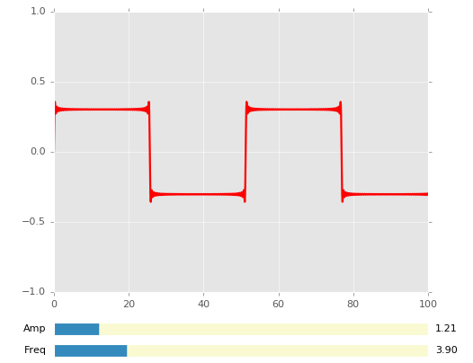

Thanks for replies:
Actually I am supposed to send a voltage square signal ranging from 0.5 to 2.5 V ( voltage amplitude) with low/high frequencies. In that case I dont know whether I have to send 60.6% for having two volts, or I have to go to the other solution using resistors?.

Re: Amplitude/PWM
For this square signal, it supposed to be dynamic values of amplitude and frequencies which submitted to my systems at different time, so I dont think that using resistors alone could help. I am expecting that I can directly send 1V, 1.5,2V maximum 3V from the pyboard to my system, can I do that?.
Re: Amplitude/PWM
You can do that with the DAC, but not with generic GPIO pins.
