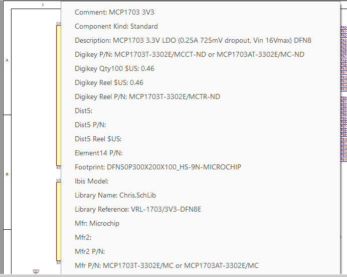

U2 is the 8 pin chip you refer to. It is an MCP1703 in DFN8 package with thermal pad (pin 9 on the schematic). When you click on U2 in Acrobat Reader it shows the correct manufacturer and Digikey part numbers for the DFN8 package. See screen shot attached.
- PYBv11 U2 pdf details.jpg (98.93 KiB) Viewed 3745 times
