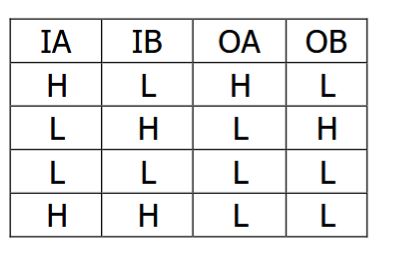

Wiring the L9110: it is dual H-bridge so can drive 2 DC motors. each motor will need 2 input pins from the micro-controller. I use 1 pin as a direction pin and the other as a PWM/speed pin. The power needed to drive the motor will go to Vcc and GND, you will also need to connect GND to your micro-controller. Each motors input controll pins will also need to be connected to the micro-controller where 1 pin can be connected as a digital high/;ow pin and the other as a PWM pin.
please note how setting the input pins relates to how the output power to the motor
as you can see when ever the 2 input pins are the same the motor is off and when ever they are different the motor spin and it will spin depending upon the order of which 1 high and which 1 is low.
Software: I use 1 pin as direction pin and the other pin as speed pin. If the direction is low then the motor will get power when ever the speed pin is high so the speed the motor will spin at will be the duty with of the speed pin i.e PWM_duty = desired_speed. If the direction is high then motor will spin the other way and the motor will get power anytime the speed pin is low so you have to invert the PWM duty i.e PWM_duty = 100 - desired_speed
