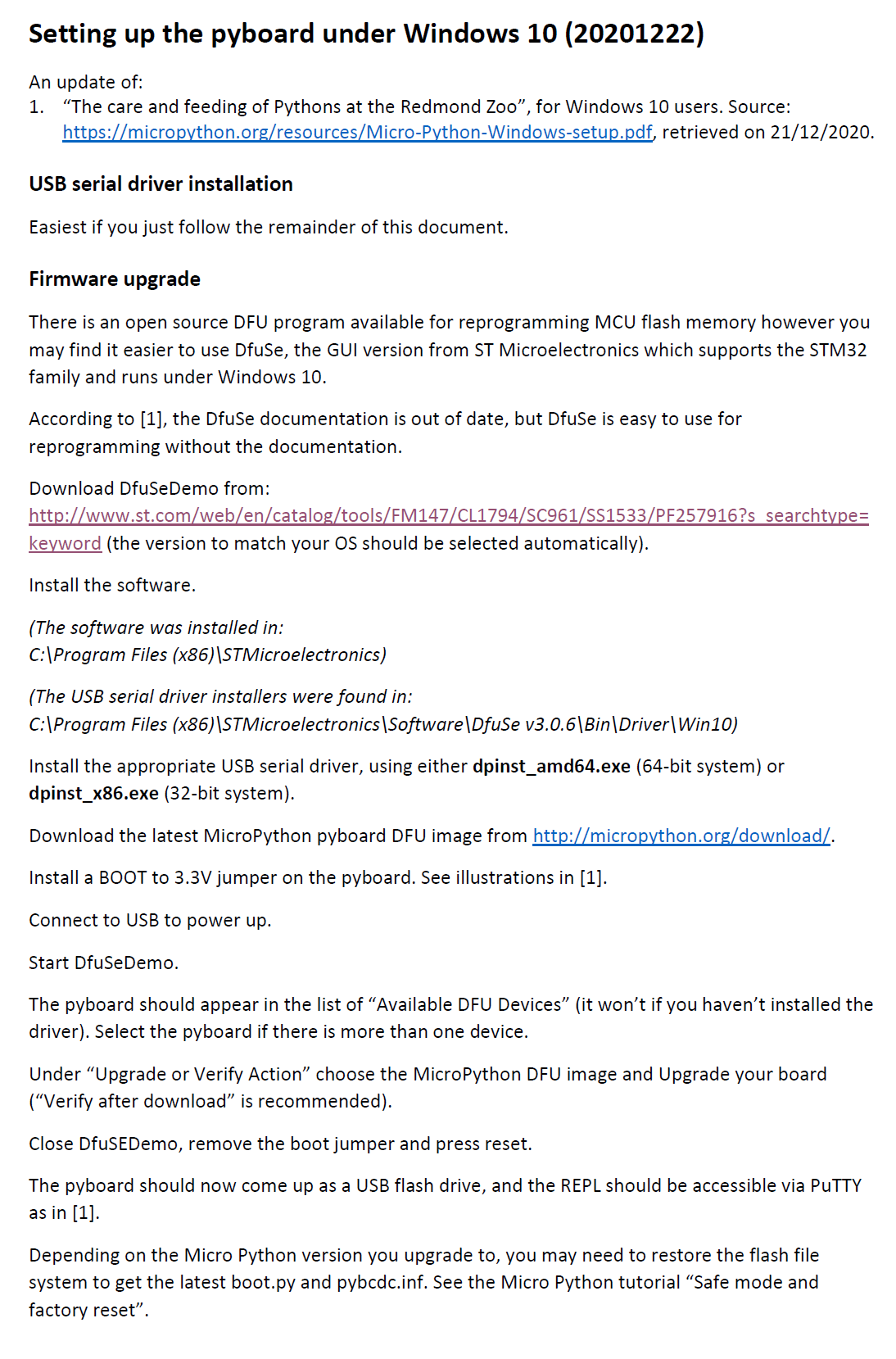

The attached may help new Windows 10 users to get up to speed quickly. I have no idea why I can only post it as a picture - that's never happened elsewhere.
SettingUpThe PyboardUnderWindows10.PNG (161.25 KiB) Viewed 2388 times
