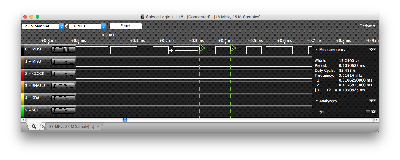

Here is snapshot of analyzer with ow.write_byte(0xa5)
The critical timing is that writing a 1-bit is supposed to start with a low pulse of < 15 us. At 168mhz, the python low pulse is 15.25us. The spec says the receiver sampling window is 30us, so the one-wire device will read the value sometime between 15us and 30us from the start of the low pulse. At 120mhz, that low pulse expands to 21.35 us. You could remove the udelay(d0) from the 1-bit write in onewire.py, and that drops the low pulse to 11.375us at 168mhz, and then you might be able to run at 84mhz (or lower) , though whether that succeeds could vary from device to device.

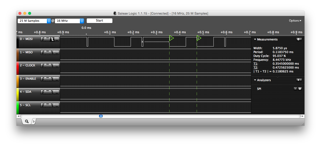

The slimmed-down onewire.py looks good. For visual comparison, here is logic analyzer with new onewire
The low pulse-width at 168mhz is 5.875us. At 84mhz, the low pulse-width is 10.625us
