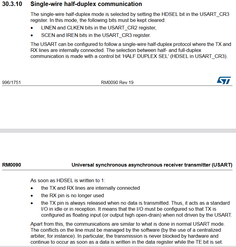

I would like to be able to drive the dynamixel directly from the UART of a micropython board.
How can 1 set the UART to hardware half duplex??
Is there a way to do it fro within the UART module or will I need to change the needed in the UART control register?
half duplex.PNG (56.45 KiB) Viewed 9861 times

I'd consider an external tri-state gate.

Depending the MCU being used, sometimes you don't need any extra hardware.
I have a driver, which you can find over here:
https://github.com/dhylands/bioloid3/bl ... rt_port.py
which should work on the STM32F4 series and allows you to the the Tx to the Rx and use that as the line that goes to the servos. You may still want an I2C style (bidirectional) voltage converter if you have any long cable runs, although it should work fine with the 3.3v control for short runs.

Thanks
        # Set HDSEL (bit 3) in CR3 - which puts the UART in half-duplex
        # mode. This connects Rx to Tx internally, and only enables the
        # transmitter when there is data to send.
        stm.mem16[self.uart_base + stm.USART_CR3] |= (1 << 3)
Here's where you put it in half duplex.
Yes that's right the dynamixel is a 5v data line. Is the UART pin the the STM32 5v tolerant as the dynamixel sends back 5v
Did you also need a pull-up on the data line or did the STM32F4 pull-up the line when idle??
Also did you just use the CPython SDK here https://github.com/ROBOTIS-GIT/Dynamixe ... ter/python just with your UART handler or did you write your own SDK for constructing the packets to send and recieve??
