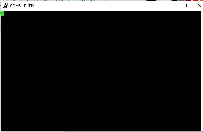

I am connected to my laptop. In the device manager I can see as COM5.
I opened a putty application and I have done serial communication. It was working for 10-20 times and i have executed some of the basic codes. I was happy that i am into micropython but after some time i am unable to open serial port using Putty application.
After multiple times hardware as well as SW reset also i am not able to open serial communication. Now i am unable to see >>> symbol on putty screen.

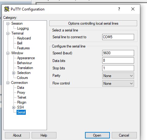

Did you disable flow control in Putty?

a) Yes, I have disabled the flow control in PuTTY. Please find attached pic.
