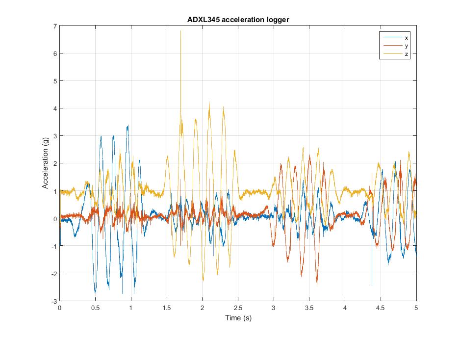

@Turbinenreiter: I pretty much want to do the same thing, high speed logging of accelerometer data onto the SD card. Would you share your code? Would help me quite a bit - I'm new to pyboard!
BTW I want to measure the effectiveness of my bike suspension fork. I intend to place the accelerometer at the top of the fork and see how resulting acceleration changes depending on air pressure and fork type. Without having tried, I assume the acceleration is beyond the +-8 or 16 g typical for most sensors, so I ordered a few ADXL375 (+-200g) instead. Here http://www.veloplus.ch/pdf/veloplus/wei ... sattel.pdf is an interesting measurement of acceleration - on your back, depending on seatpost suspension. I just purchased an ADXL345 breakout board for starters, it is pin (and maybe software) compatible with the ADXL375. For connecting the part, I'm not sure whether I just fix the ADXL375 upside down on a small PCB and solder thin wires directly at the part or remove the ADXL345 from the breakout board and solder the ADXL375 instead - I have equipment for both, I'll see...
If I would do this in C on the STM32, I'd have the following structure:
- Initialize the sensor for 3200 Hz output rate, use FiFo, generate Interrupt when FiFo is full
- interface via SPI (> 2 MHz)
- In the interrupt routine, do 32 times an SPI read (6 bytes each for XYZ 16 bit data), maybe DMA (but not necessarily), unfortunately you can't do a single read for reading out the FiFo and unfortunately2 SPI reads at 2 MHz require an additional delay between reads as the FiFo is so slow.
- Write data in a buffer, when 512 bytes are full, write to SD card (SPI) via DMA.
Not sure if this can be done on the pyboard. Of course a few missed samples would't be the end of the world in this application, but most elegant would be if a seamless recording would work. I am open to suggestions here...

Re: data write speeds and broken SD cards
Actually it turned out to be much simpler than I thought. Instead of using interrupts and DMA, I just enabled the ADXL345 FiFo and configured the INT1 output for "watermark" mode with 20 entries (fifo is 32 entries). I set the ADXL345 for 3200 Hz sampling and monitor the INT1 line. If it is 1, I read 20 samples from the FiFo and write them to the SD card. This is pretty simple and works out quite well:
I just record 5 seconds here, I'll have to add stopping with a switch and incrementing the file name.
What was a great help (and what I recommend to anyone) is hooking up a logic analyzer to the SPI pins. I used the Saleae logic, quite affordable and with SPI (and others) protocol analyzers. Here's a screenshot: The ADXL345 is connected via SPI at 5 MHz clock rate (I2C is too slow and I hate the protocol). At 3200 Hz sampling rate, the INT1 goes high every 20/3200 = 6.25 ms. The readout/file write takes 1.3 ms, so there's plenty of time. If the write buffer has filled up to 512, a sector is written to the SD card, which takes about 1.2 ms (427 kB/s).
I wrote a small import function in Matlab (I use it daily and I'm a total Python newbie, so this was quicker), here's a sample figure: (somehow this image inlining doesn't seem to work in the preview)
Next I'll have to replace the ADXL345 on the board with the ADXL375 (which I got as samples from Analog), QFN rework...
f=open('/sd/test.bin','wb')
for k in range(160*5):
# wait for FiFo to be filled
while int1pin.value()==False:
pass
# read 20 values and write to SD card
for i in range(20):
nCS.low();spi.send_recv(CMD_RD,b7);nCS.high()
f.write(b7)
f.close()
- untitled.jpg (71.55 KiB) Viewed 22368 times
