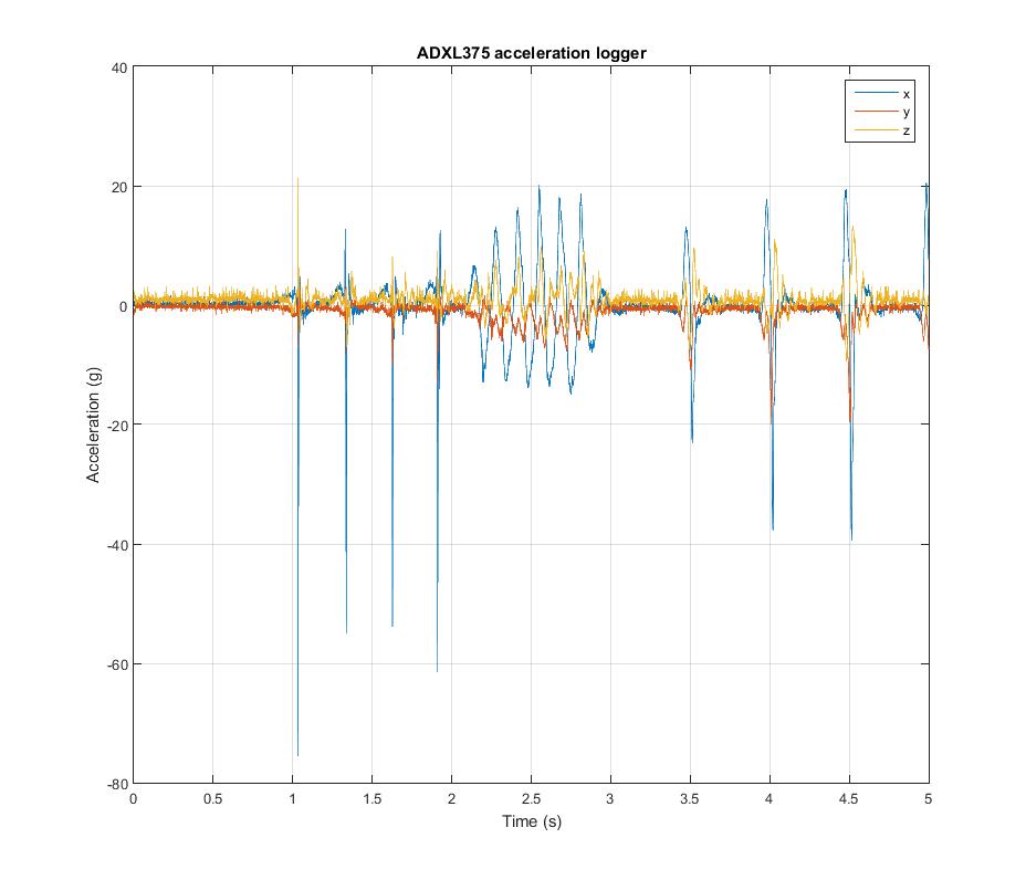

I used a matlab script to display the results:
fileID = fopen('test.bin');
A = fread(fileID);
fclose(fileID)
A=reshape(A,7,[]);
x=A(2,:)+256*A(3,:);
y=A(4,:)+256*A(5,:);
z=A(6,:)+256*A(7,:);
for i=1:length(x)
    if x(i)>32767
        x(i)=x(i)-65536;
    end
    if y(i)>32767
        y(i)=y(i)-65536;
    end
    if z(i)>32767
        z(i)=z(i)-65536;
    end
end
sc=49e-3;
x=x*sc;y=y*sc;z=z*sc;
t=(1:length(x))/3200;
plot(t,x,t,y,t,z)
legend('x','y','z')
 grid on;
 xlabel('Time (s)')
 ylabel('Acceleration (g)')
 title('ADXL375 acceleration logger');
I also attached one sample file.
