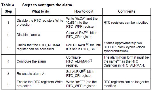

I'm looking to use the RTC allarms to activate at a certain HR:MM two relays and after a certain time (20-40 minutes ) deactivate.
I've started reading the AN3371 documents about the usage of RTC in STM32F4 MCU and then the RM0090 Datasheet to understand which register were involved and whic sequence use to set the allarms.
Looking page 11 of AN3371 I found this clear table that explain how proceed to set the allarms
and in the below part of code I think to have implemented what required to set the Allarm A every day at 23:00

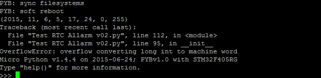

The problem is that wen I run the code i got this error that apparently is related to the fact that i try to set in the register a value grater than max value , but looking the register bit setting on descriptions RM0090 page 815 I think to have done in the right way.
Where I'm wrong this time ? :roll:

Sorry I forgot to cancel part of code , anyway the line of code involved into the problem is in Class RTC_SETALA.
Thanks. Roberto

The error is in this line
stm.mem32[stm.RTC + stm.RTC_ALRMAR] |= 0x86230000
It occurs because of the way MicroPython stores integers. To conserve RAM it stores small integers in a single 32 bit word, whereas Python arbitrary precision integers are stored in an object. To differentiate between the data types which are stored in a single word, there is a constraint in that small integers must have the two most significant bits equal. Usually this is transparent, but you've hit a case where it is not. The value 0x86230000 does not meet the constraint and hence is stored as a long integer so a type conversion error occurs when you try to assign it to a 32 bit register. The same error can be provoked as follows:
from array import array
a = array('i', (0,))
a[0] = 0x86230000
I'm sure someone will come up with a more elegant solution, but here is my suggestion. The first argument is the top 16 bits, the second is the bottom 16 bits, and the third the address where the result is to be assigned.

Unfortunately my solution still isn't correct as the address of the RTC itself falls foul of the limitation: the RTC registers have a base address of 0x4000000. The following code lets you write arbitrary values to an RTC register, demonstrated here with backup register 0. Note that we clear down the top two bits of the address before passing it to the assembler, which then sets bit 30.
