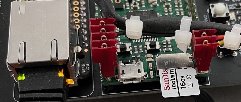

Seeing all the resets going on in my previous reply, I decided to ditch the USB REPL and switch it to UART 6 on my PyBoard. Thankfully, I had left one set of UART pins free on my PCB, on the off-chance that I might need a spare serial port. I've tested this now with a bare serial terminal emulator, rshell, and Thonny. In all cases, machine.reset_cause() returns the expected result corresponding to either soft reboot or hard reset / machine.reset().
I'm fortunate that this is an acceptable solution for me, since the REPL is only used for development (see the squirrelly cable I patched together from an old FTDI C232HD cable I had laying around).
