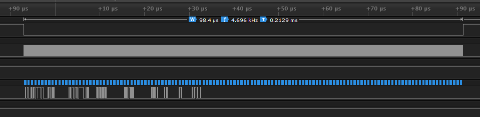

As you can see from the attached snapshot from Saleae that the frame(width of the message) is 98.4uS
Do you think that the pyboard can handle this kind of stream?
Do you think that other python modules can handle this kind of load?

It's as I said above. You're getting 128*8=1024 bits at 10MHz so your frame period is indeed 98μs. It's the 200μs gap between these frames which may be the limiting factor, depending on what you do with those 128 bytes after you've received them.
