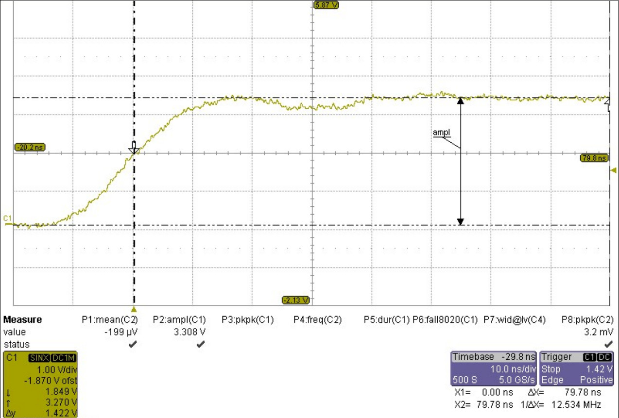

Just a quick test run. Scope probe connected with two wet shoelaces to Y5 and GND of a PYBLITE to simulate lousy wiring.
The 150Ohm load was just measured with a step whereas other tests used a pulse.
GPIO_SLOW_150OHM
GPIO_SLOW_OPEN
GPIO_FAST_OPEN
GPIO_SLOW_150OHM
GPIO_SLOW_OPEN
GPIO_FAST_OPEN
- gpio_slow_150Ohm.jpg (152.46 KiB) Viewed 8214 times
- gpio_slow.jpg (153.38 KiB) Viewed 8214 times
- gpio_fast.jpg (155.24 KiB) Viewed 8214 times

Thank you, interesting results - my doubts were clearly unfounded. It's odd that STM don't characterise this useful feature in the datasheet.
