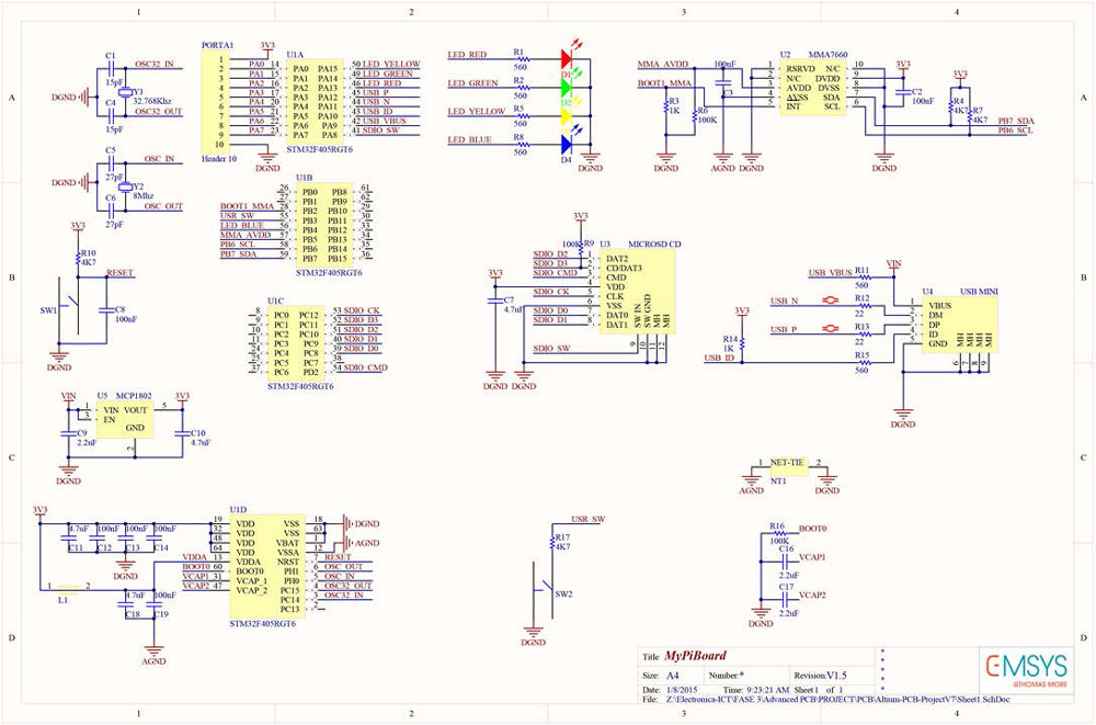

As a student i got the opportunity to make the micropython PCB. Currently i got my board working but only with programs made in C. When i try to download the micropython core situated in the stmhal directory of the git it doesn't respond. It doesn't even get recognised as a device in mac of windows (in vmware). Building the files is no problem, download the dfu file through DfuSe is aslo successful.
the symptoms are similar to this post: http://forum.micropython.org/viewtopic. ... oard#p2592
however, the cause is not the same as my VBUS signal is connected to PA9.
i'm sensing there might be something wrong with my schematic although it is almost the same as the original
I must say that not all the components are placed on the board yet. only the controller, necessary capacitors, usb connector and pull up/down resistors, 1 led (D4) and the reset button.

I'd recommend that you change this #if 0 to #if 1
https://github.com/micropython/micropyt ... #L382-L392
and move the entire #if block after the call to uart_init0() a few lines down, so that your code looks like:

and see if you get anything showing up on the UART. You can put printf calls in the code after the uart_repl is setup and you should see them on the UART.

You can also use the led_debug function to see which parts of the code are actually being executed. If it's getting to the REPL loop but not responding on the USB then something is wrong with your USB hardware.
