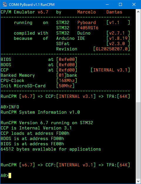

Today with the STM32Duino v2.3.0 and STM32Programmer v2.11.0 I did get it to work :)
Now I could use the Arduino-IDE with my Pyboard v1.1 Clone (STM32F405RGT6)
and the compiled RunCPM (CP/M-Emulator) could use the MicroSD-Slot :)
@apples: from your Tutorial (Many Thanks for that) I had not to change variant.cpp anymore (FLASH_LATENCY_5)
(seems to be standard now for the STM32F4x group - wasnt anymore in the file)

Now also the RunCPM v6.7 Update
for the Pyboard v1.1 (STM32)
with the onboard SDCard-Slot 😉
Get it at
https://github.com/.../GL20250207_RunCP ... yboard.zip
