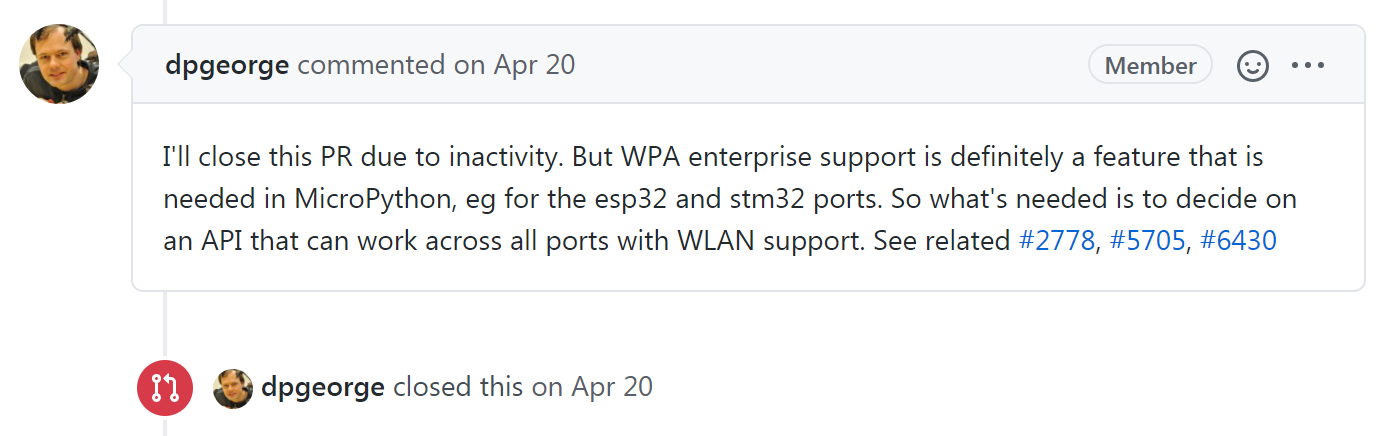

2021-05-20 07_06_06-RFC_ cc3200_ Support WPA-Enterprise networks (802.1x auth) by noahwilliamsson · .png
2021-05-20 07_06_06-RFC_ cc3200_ Support WPA-Enterprise networks (802.1x auth) by noahwilliamsson · .png (67.47 KiB) Viewed 19222 times

micropython really needs to add this connectivity
with all the appropriate protocols.
