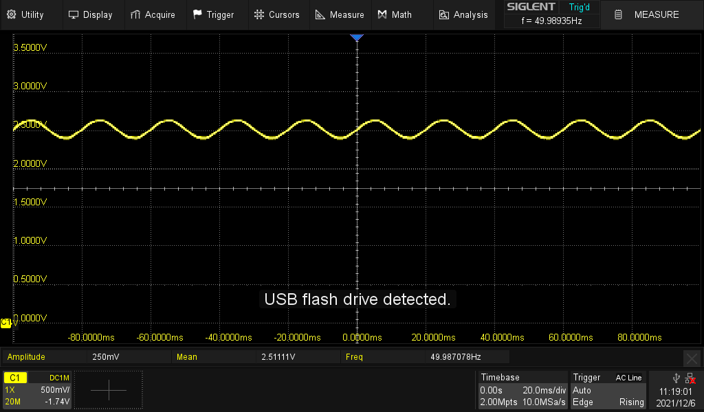

Just to show what happens, i have set up a test with an ACS712-05 and a 0.45A AC current. The Picture below shows what you get: an output voltage of 2.5V with a 50Hz AC overlaid with 250mV Pk-Pk or ~0.088V RMS. This 0.088V is what you should get when using an AC measurement with a voltmeter. The mean value of ~2.5 V is what you read in the DC setting of your voltmeter, and that will stay with or without current at the sensing pins.
