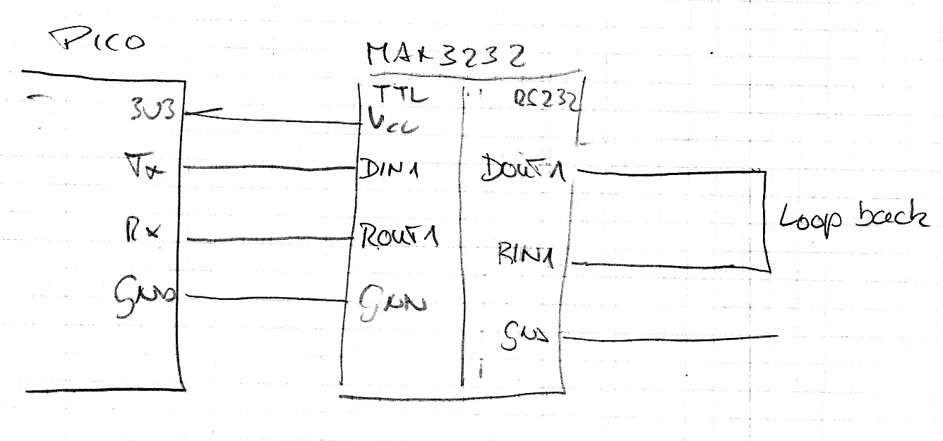

What's puzzling me is that the loopback test does not work. That is the minimal test case. Until that one does works, is make no sense to connected external data sources.
Re: serial data reading with pico
Post by Roberthh » Fri Jul 22, 2022 2:40 pm
So the wiring for loopback should be as in the sketch below:

Good. Now you know it works up to the RS232 side. Next: what is connected to the RS232 side?
