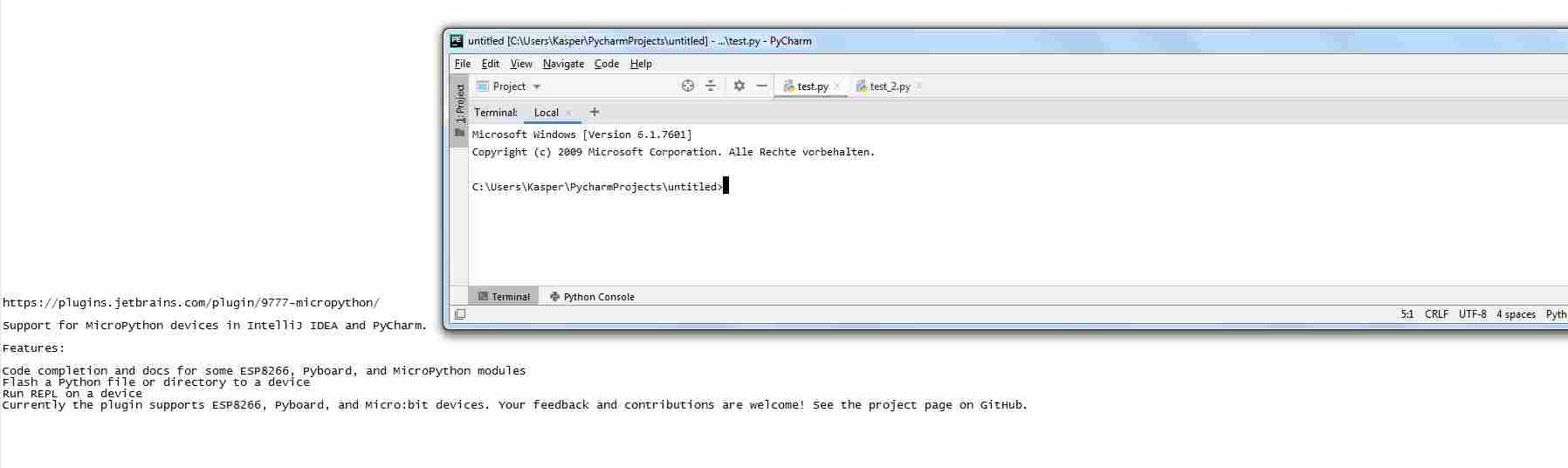

Post by apollodriver » Fri Sep 27, 2019 2:26 pm
hi there
many many thanks for all the hints and the very fruitful discussion here.
i just have installed PyCharm on
a. my win-box /(win7 ) in the office
b. the Mx-Linux-System at home: which runs on MX-Linux.
the version: pycharm community-Edition 19.2
i then installed the MicroPython extension
i am going to test the sytem (s)
