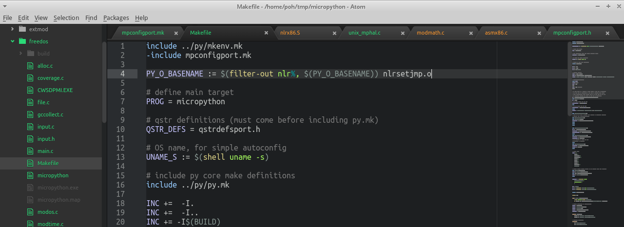

dhylands wrote:You can play games in the makefile too. Like this: https://github.com/dhylands/micropython ... kefile#L14
This does not work, also I found that MICROPY_NLR_SETJMP in mpconfigport.h does not affect on make of nlrx86.S at all. It looks like nothing from mpconfigport.h is defined when preprocessing nlrx86.S. But __i386__ looks defined. Maybe this is djgpp issue.
Done https://github.com/micropython/micropython/issues/1647
This does not work
OK - it works fine for me. Maybe you've got a typo or you put it in the wrong place in the Makefile?
Looking at this again, I think that you need to add -DMICROPY_NLR_SETJMP to CFLAGS and not mpconfigport.h

dhylands wrote:Looking at this again, I think that you need to add -DMICROPY_NLR_SETJMP to CFLAGS and not mpconfigport.h
Yeah, adding of "CFLAGS_MOD += -DMICROPY_FREEDOS=1" to the Makefile and "#if !defined(MICROPY_FREEDOS) || !MICROPY_FREEDOS" to nlrx86.S solved the problem. 8-)
dhylands wrote:OK - it works fine for me. Maybe you've got a typo or you put it in the wrong place in the Makefile?
Hm, I've just copy your string "PY_O_BASENAME := $(filter-out nlr%, $(PY_O_BASENAME)) nlrsetjmp.o"

Oh, I was too fast and did it wrong, of course I should insert "-DMICROPY_NLR_SETJMP" and no changes to nlrx86.S
added:
Yeah, it works fine, so two left: tgamma and asmx86.c/asmx86.h difference

Post by dhylands » Wed Nov 25, 2015 10:56 pm
Perhaps add
$(info PY_O_BASENAME = $(PY_O_BASENAME))
before and after the line and see what it did.
What version of make are you using?
Doh - no the problem is that it needs to be after the include of py.mk (which is where PY_O_BASENAME is setup)

It does not matter, since "-DMICROPY_NLR_SETJMP" do the job.
