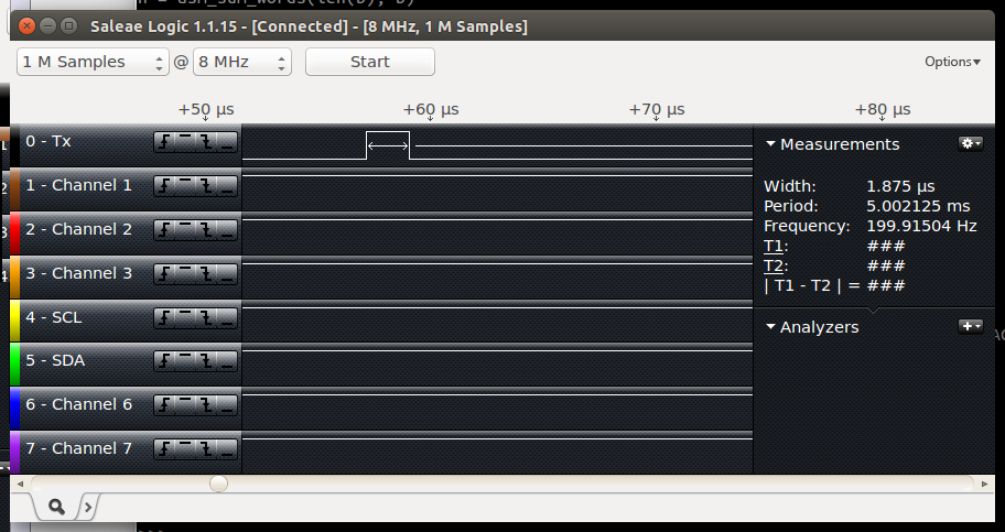

I had to add the Pin statement to get the pin configured as an output (they're configured as an input by default), then I get this output:
1.875 usec corresponds to 315 CPU cycles (at 168 MHz), which is about 6 cycles per loop. There's 1 for the SUB, 1 for the CMP, 1 for BGT and presumably 3 for the pipeline reload for taking the branch (the ARM documents say it takes 1 to 3 depending on alignment, width of instruction, and whether the processor managed to speculate the address properly or not).

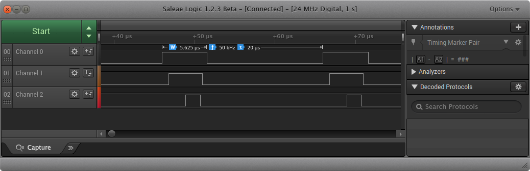

I decided to add some instrumentation to the timer_irq. I used 2 GPIOs.
I turned X1 on at he beginning of timer_irq_handler and turned it off at the end.
I turned X2 on just before calling mp_call_function_1 (the C function which calls the timer callback) and turned it off just after returning.
I then ran the "corrected" flash_int.py from my previous post with a freq of 50kHz. Here's my scope capture:
What I'm seeing is that time spent in timer_irq_handler is 5.625 usec.
The time spent inside mp_call_function_1 is 4.167 usec (included in the 5.625usec) and the time that the line toggled by the python assembler routine is 1.833 usec.
This gives an upper bound of 200,000 timer IRQs/sec. This would cause 100% of CPU to be used for handling timer IRQs and the REPL will not be able to run.
What exactly are you trying to do?
To go faster than the above, you're going to have to use a different technique or code it in C.

I ran your 2-channel code with the instrumentation and I'm seeing this:
The bottom 2 are where the asm routine is writing. C6 is the 3rd line, C7 is the 4th line.
However, if you look at the 2nd line (high time is 17 usec, which means that about 15 usec is being spent in your assembler routine.
