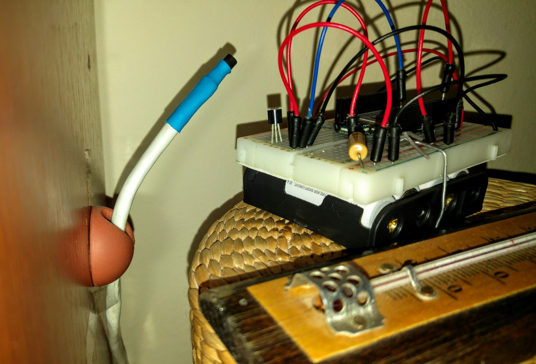

Saran
Posts: 17
Joined: Thu May 28, 2015 6:52 pm
Re: Onewire and DS18B20
Post by Saran » Wed Oct 28, 2015 9:57 am
This is the "test setup":
I've measured (with cheap IR temp meter) WiPy at 26.9 C, so I believe it can't that much influence the sensor.
@Damien: I tried with hairdryer (up to ~30C). Same relative discrepancy.
@dhylands: I don't have the problem with discrepancy of DS and analog thermometer. I've tested up to 4 DSes on the same bus and on the same spot (milimeters away) with the Raspi and their results were within 2% of each other (or ~0.05 C).
What bothers me is that the same sensor now shows 0.8 C difference when the only difference is that it's connected via WiPy.
danicampora
Posts: 342
Joined: Tue Sep 30, 2014 7:20 am
Post by danicampora » Wed Oct 28, 2015 10:27 am
Could it be that there's an error in the temp calculation?
kfricke
Posts: 342
Location: Germany
Post by kfricke » Wed Oct 28, 2015 4:10 pm
Maybe there is a difference in Vcc (both 3.3V or 5V), which causes that deviation? I do use a lot of those sensors for years and they differ in temperature readings all across the board within the already mentioned tolerance. So imo their readings are to be interpreted "relative" only.
There might also be a reason hidden in parasite-powered mode of them!?
In the last iteration of our sensor network (spread across 6 data-centers) we decided to not use them in parasite-powered mode, which makes them far more reliable in means of reading performance.
