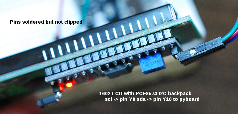

Post by keithostertag » Tue Feb 13, 2018 5:13 am
I'm trying something similar using a pyboard and the 1602 LCD and the PCF8574 I2C backpack, but can't get it properly wired. I'm using 2K pull up resistors, I haven't tried loading any software yet just trying to scan to make sure it is wired correctly. The LCD shows only a single row of blocks.
Here's what I get:
>>> from machine import I2C, Pin
>>> lcd = I2C(scl=Pin('Y9'), sda=Pin('Y10'), freq=10000)
>>> lcd.scan()
I have a different device on the other I2C bus and it is working:
>>> i2c = I2C(scl=Pin('X9'), sda=Pin('X10'), freq=10000)
>>> i2c.scan()
[35]
I'm powering the LCD independently with a 5V source. I've also tried resistor values of 5K and 330ohms. AFAIK I've got the backpack soldered to the LCD correctly by looking around the Internet for photos. Adjusting the contrast shouldn't affect the scan, correct? Any ideas of what I should be checking? (I'm still new to this).

Post by mcauser » Tue Feb 13, 2018 5:33 am
I thought the PCF8574 I2C backpack already has onboard I2C pull-up resistors?
You should see the PCF8574 backpack show up in an i2c.scan() as 0x20 - 0x27 (configurable with A0,A1,A2 solder pads).
The contrast is independent of the i2c.scan(). It's just a potentiometer between VCC and the backlight LED.
If it's bright enough, you don't even need the backlight on. Some of the backpacks contain a jumper for the backlight LED.
Until you run the HD44780 display initialise commands, seeing a row of blocks isn't out of the ordinary.
eg. https://github.com/dhylands/python_lcd/ ... cd_test.py
It should show up on I2C scans without being initialised. Try removing your additional pull-ups and i2c.scan() again.

Post by keithostertag » Tue Feb 13, 2018 5:38 pm
Thank you! That's a big help, but still no joy with or without pull up resistors.
Do I need to select an address, or am I correct that the default address of 0x27 needs no jumpers?
To make sure I am doing this correctly, here's what I've done:
I copied the contents of pyb_i2c_lcd_test.py to the pyboard's main.py file, and also copied lcd_api.py and pyb_i2c_lcd.py to the pyboard (I'm not using an sd card). Reset, and I see the pyboard's LED's flashing briefly, but no change in the LCD. I reset again then attempt to scan the bus but again (after connecting via the screen program since I'm using Linux from the command line) still get only an empty set.
Did I misunderstand... does running the pyb_i2c_lcd_test.py initialize the bus?
Also, how do I select an address? Mine are not jumpered on the backpack, just solder pads. I can't find a reference showing how to relate the A[0..2] addresses to the LCD pins, for instance.
Addendum: now I see an error:
Running test_main
  File "main.py", line 48, in <module>
  File "main.py", line 16, in test_main
  File "pyb_i2c_lcd.py", line 24, in __init__
OSError: [Errno 5] EIO
MicroPython v1.9.3-240-ga275cb0f on 2018-01-11; PYBv1.1 with STM32F405RG
Line 24 in __init__ is
self.i2c.send(0, self.i2c_addr)
, so it's an address problem? I've got the scl connected to pin Y9 and the sda connected to Y10 on the pyboard.
Re: LCD 1602 - Library
Post by dhylands » Tue Feb 13, 2018 10:03 pm
Your frequency is probably too low. You're showing 10,000 when it should be 100,000.
The pyboard includes pullup resistors on Y9 and Y10.
The pyb_i2c_lcd_test.py assumes that the LCD on I2C bus 2, which is pins Y9 and Y10:
https://github.com/dhylands/python_lcd/ ... est.py#L15
Some earlier versions of this used bus 1, so make sure your file has a 2 there.
Make sure that you can see a single line of black squares when you power on the LCD (this should happen just by applying power - no I2C connection is required). If you can't, adjust the pot until you can, otherwise you won't see anything on the LCD even if it is working.
With no solder pads of the A0..A2 connected then the low 3 bits of the address will be 1's. Each pad you solder changes that pin to a zero.
0x27 = 0 0 1 0 0 1 1 1 or 0 0 1 0 0 A2 A1 A0
Be aware that i2c.scan reports addresses in decimal, so 0x27 = 39 decimal. The fact that you have a device 35 showing up would map to address 0x23 suggests that your A2 address pin is soldered or perhaps has a bad solder job on the pullup resistor for the A2 pin.

Post by keithostertag » Wed Feb 14, 2018 12:21 am
Thanks Dave and mcauser!
So I finally discovered the problem.
I removed everything else from the setup (to prevent complications) and changed the frequency as you suggested and it still didn't work... but I was able to finally get a scan working... and the default address of this board is 0x3f! (No soldering issues)
>>> from machine import Pin, I2C
>>> lcd = I2C(scl=Pin('Y9'), sda=Pin('Y10'), freq=100000)
>>> lcd.scan()
[63]
After changing the DEFAULT_I2C_ADDR to 0x3f in three files (main.py, pyb_i2c_lcd.py, and pyb_i2c_lcd_test.py) the code works as intended... yay!
I bought these LCD's and backpacks from China, so I guess sometimes addresses are different...
Thanks again Dave and mcauser and everyone else for this thread and your help! I would still be stuck if not for you guys, and there's still a lot to learn...

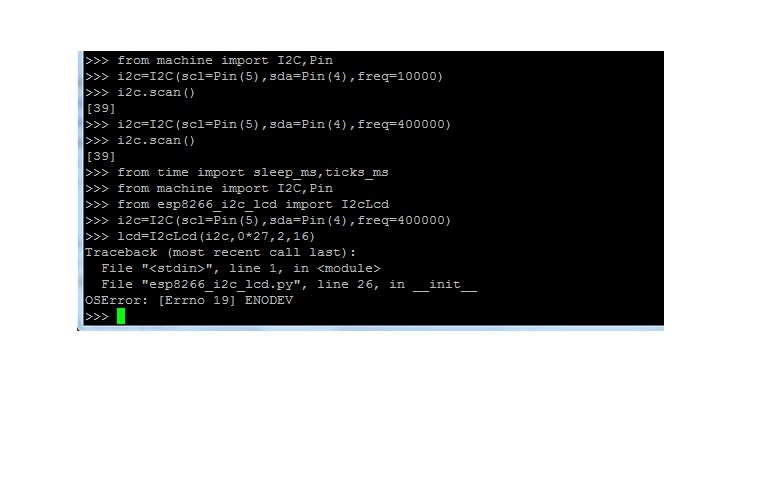

Post by RajaRamesh » Sun Jun 09, 2019 5:03 pm
mcauser wrote:
Fri Jan 06, 2017 4:56 pm
from time import sleep_ms, ticks_ms
from esp8266_i2c_lcd import I2cLcd
i2c = I2C(scl=Pin(5), sda=Pin(4), freq=400000)
lcd = I2cLcd(i2c, 0x27, 2, 16)
lcd.putstr("Hello ernitron\nIt's working!")
lcd.clear()
lcd.putstr("Using dhylands\npython_lcd")
lcd = I2cLcd(i2c, 0x27, 4, 20)
lcd.putstr("WeMos D1 Mini with  PCF8574 I2C backpackWorks with HD44780s:08x2 16x1 16x2 20x4")
lcd.clear()
lcd.putstr("line 1\nline 2\nline 3\nline 4")
Hi, i am trying to display some text on lcd screen with the help of above code. but i am getting below error. could you please let me know what was wrong?
Post by Roberthh » Sun Jun 09, 2019 6:03 pm
What do you get with
print(i2c.scan())

Post by mcauser » Sun Jun 09, 2019 8:05 pm
Did you add pull ups on the SDA and SCL lines? I2C requires them.
Pins D3 (GPIO0) and D4 (GPIO2) have onboard 10k pull ups for setting the boot mode.
If you don’t want to add extra hardware and don’t mind D4 led blinking, use the two pins for I2C instead of D1 (GPIO5) and D2 (GPIO4). I use D4 for clock so it blinks on activity.
Hang on... these backpacks come with onboard pull ups. You shouldn’t need to add additional ones or use D3/D4.
