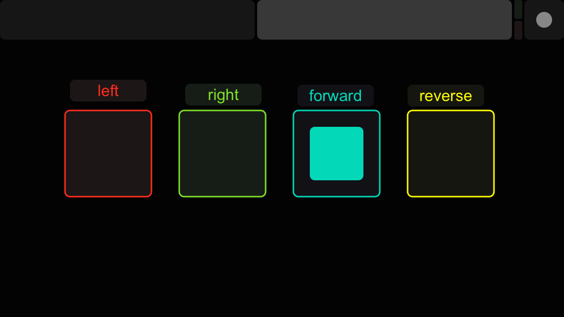

I have now updated the code at:
https://github.com/jeffmer/micropython-upybbot
I have included the Arduino sketch that implements a UDP server on the ESP8266 for OSC messages and the template for the TouchOSC app on my iPhone used as the controller. This follows the B_ROBOT approach. The controller implements two approaches - faders or buttons - the operations should be obvious from the screendumps below:
@pythoncoder. I agree that having a concurrent implementation would be best. The issue is that to get real-time response a pre-emptive scheduler is needed rather than the cooperative scheduling that can be achieved using yield. As you suggest, the only plausible approach is to use a timer driven interrupt service routine and forego floats.
BTW. The poll routine that gets wifi messages in the revised code takes approximately 1.5ms if there is a message to process so it is within the 5ms budget.
